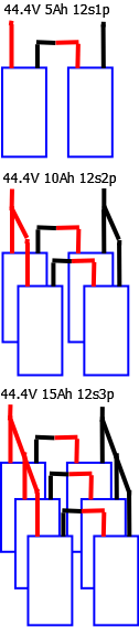

Quick question on this battery
I purchased six of these batteries
http://hobbyking.com/hobbyking/store/__11937__Turnigy_nano_tech_5000mah_6S_25_50C_Lipo_Pack.html?strSearch=5000.6s
I have two batteries in a pack in which makes three packs.
I am using two packs together now to make 44.4 volts (I am assuming)
How many ah will the packs have and when i install the third pack howmany ah will it be total?

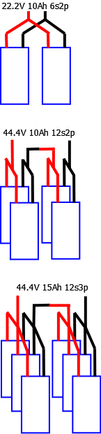

Alternate way, vs above, to connect:
Wow I need to go back to and learn all of this.
I had someone wire up my batteries for me.
Obviously I was not able to do it on my own. But I was never told how many AH that I had.
The only thing I know is that it equals up to 66.6 volts.
I was hoping for 66v 10ah but i dont know if that was even possible.
I also dont understand the terms that are being used.
