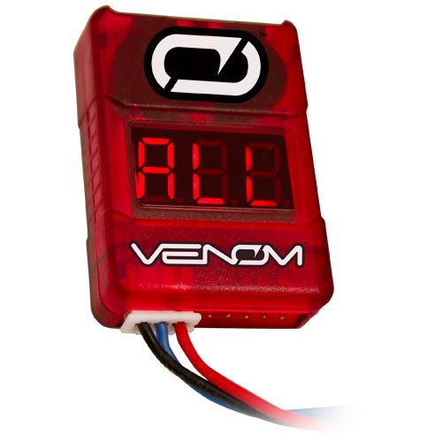

Alternative 2 - off your balance plug run something up so it's visible. I got some 8s extensions to have the venom LCD on top so it's visible (not installed there yet).
It's alright. I plug in my batteries and connect the alarm at the same time. it's basically a nicer version of the basic alarm (in a case). Nothing fancy and i set the cutoff alarm voltage to 3.6/3.7. It constantly cycles through individual cell voltages and combined voltage which is a bit annoying.
