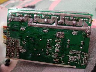

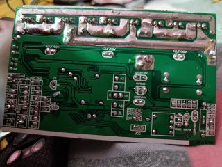

I have these two controller,both pcb looks similar,both are 48v 500w,but one has 5 pin s866 display support but another has only single pin display/speedometer output wire. While both pcb match, i figure out all the pins for 5pin display,so if i connect them will s866 display work on another controller ??

Have you used either controller and know that they work when wired up? Never seen a controller with a single wire output for a speedometer. Why don't you tell us how the connections will differ between the two setups, using the names of the pins.
I don't think your idea will work. The right hand side of the board has a port used for JTAG programming, probably used to load the firmware into the board's microcontroller. They probably use this to set the board up to recognize its S866 inputs, Then again, I'm just a crusty skeptic I don't feel it's worth the time to experiment., unless you want to learn..
Good luck.
