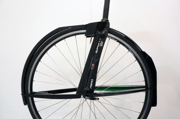

Aero mudguards. Yes they look gastly but they do work.
Logic11
⚡ Regular
May 2, 2022
395
I know whats going to happen:
Bikers are going to take one look and due to the looks are going to have a negative emotional reaction so powerful that their ability to think rationally will be temporarily overridden.
Decision made; imaginations spring into action coming up with every ingenious reason why they don't/wont work.
(It's a shame imagination is seldom kicked into high gear for any other reason but that's just how it is... :) )
The top of a wheel is traveling forward with 2X the speed of the bike. (while the bottom is standing still relative to the ground)
Aero drag goes up with the square of speed and the power required to overcome said drag; with the cube of speed.
As as horrible as these look, they will in fact give you more speed and/or range.
Probably not as much as a good looking fairing, designed with the help of Airshaper, but they will... once you are able to deduct the 'Revulsive Drag' :)
I think these may fit better with the looks of recumbents and velomobiles..?
After all just about anything will help improve the looks of what looks for all the world like a giant wheeled dildo! :D
$499 for aerodynamic carbon mud guards? Yikes.

What’s the deal with the spokes on the second bike?
Those are actually VERY clever, if too cheaply designed and made:
They weathercock, making the spokes more aero, no matter which direction a crosswind is coming from.
ie: Your ride will be less unsettled by crosswinds.
Even Better!:
IF these were lightly sprung to return to center; any side wind would be turned into a tiny bit of forward rotational force by them..!
ie: A very slightly wind powered bike that's less affected by crosswinds!
NB that something similar could be done to any vertical-ish round bar of the bike frame..!

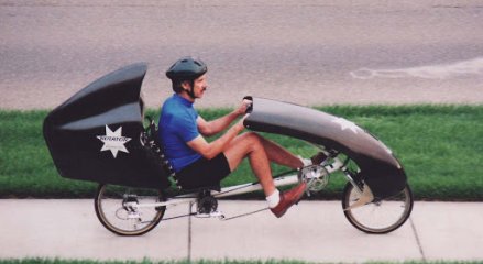

That's a damn nice aero recumbent! Love it!
I NB that the top of both wheels, where they are mostly moving forward at 2X the bike speed are in fact faired in...
However most recumbents dont have the above fairings.
One a similar tadpole recumbent for eg; I think Aerodefender style fenders may well improve the looks.
IMHO the Birzman fender with sides over the very top bit of the wheel may give better Cd numbers and look better..?

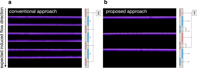

Another interesting rabbit hole to go down is DBD: Dielectric Barrier Discharge.
Its used (or is being tested) on Boeings and things as a means of decreasing the aero drag on the landing gear without any fairing in etc.
Its basically 2 strips of aluminum tape; one stuck to the top of piece of Kapton Tape and the other to the bottom of the same piece of Kapton Tape.
Then you apply high volts/low amps to the aluminum tapes, (the equivalent of static electricity really)
So it's easy, if 'Ouch!-ey', to experiment with. :)
It should look cool as hell at night too.
This paper has some great pictures/diagrams to look at and is a more logical and easy way of doing DBD IMHO:
