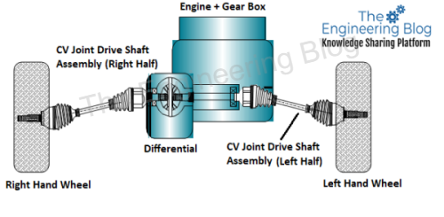

Oh and: If a universal cross:
Is that a universal cross similar to the ones in car steering columns where the steering shaft bends back towards you PaPaSteve?
I guess so? So than you have to hold the handlebars up as well as turn them??
No, not a CV joint.
On a bicycle when the hand position is behind the steering pivot the movement is referred to as "tiller".
Like a small sailing boat where the rudder is in the water, the pivot axis is on the stern, the control handle that protrudes forward is called the "tiller".
To turn left the riders hands move to the right.
In this bicycle example where the fairing is mounted to the steering there is an asset of a "weather vane" effect that self stabilizes the bike in a cross wind.
This is required numerous experiments and ample patience to find the "sweet spot".
No, not a CV joint.
