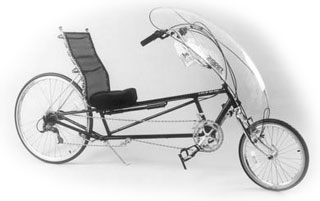

My total personal experience with fairings was running a Zzipper fairing on a RANS V-Rex, set up with dual 26" wheels. I ran it one winter. It was great for keeping warm in frigid temps, but funneled road, and drivetrain, noise up to my ears. I was slightly faster on the flats, slower uphill, and too fast downhill. Riding in hot, humid Virginia summer wasn't comfortable. Fairings tend to work better for really strong riders, or with a motor.
The design parameter of a streamlined vehicle is to slip through the air with minimum drag with zero lift.
Lift means the tires no longer touch the ground . . . a dangerous situation on public roadways.

My first attempt to do a fork / handlebar mounted fairing was this bike :
Originally the fairing was mounted 4" further forward and was virtually unrideable.
Moving it back 4" made all the difference.
Note how much fairing is behind the steering axis as a means to balance the effect of what's in front of the axis.
EZ Racer with zZipper fairing has a similar method where there is more fairing behind the steering axis verse in front.

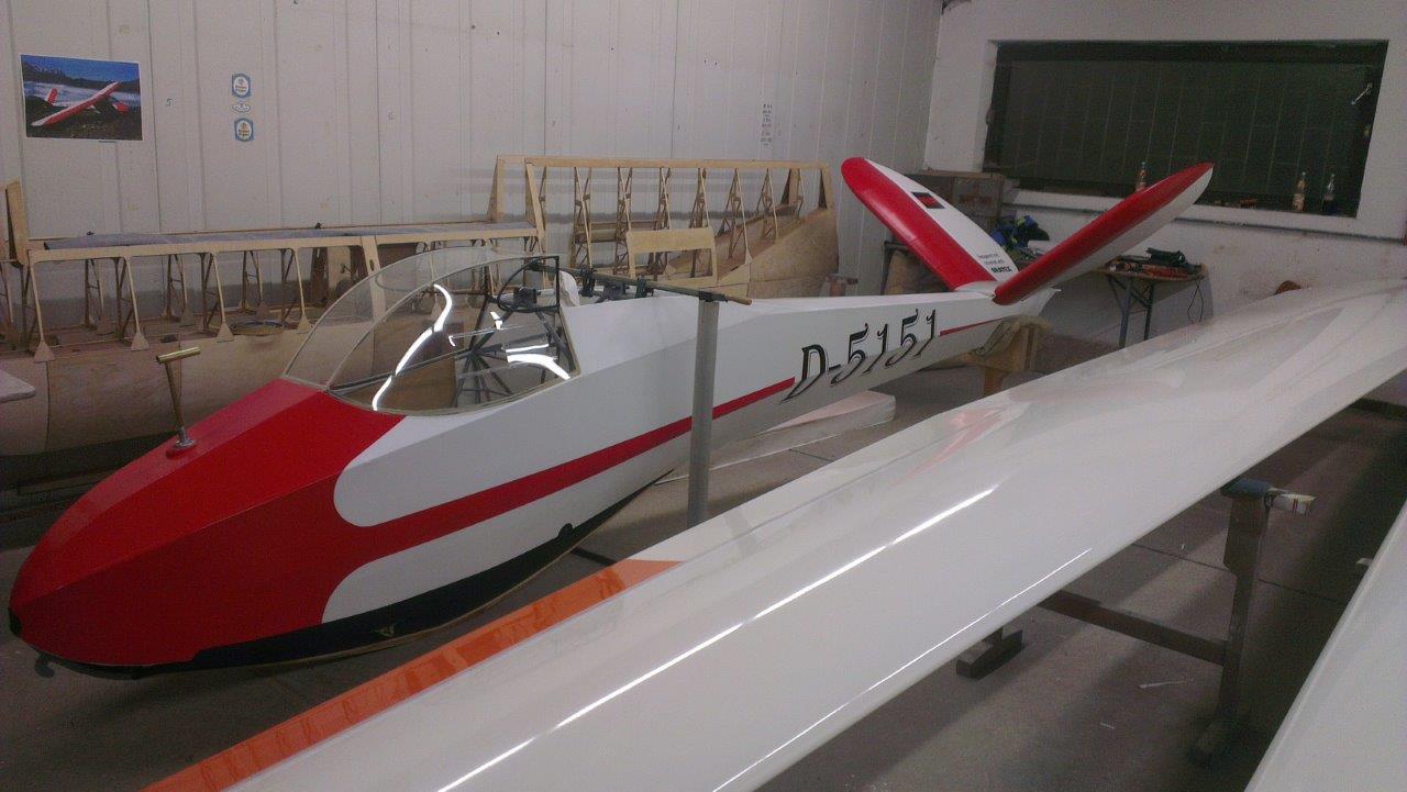

Not trying to belittle the fabric coverings PaPaSteve (and everyone), but provide the info and 'how to' to improve them:
If the aircraft fabric technique where used to cover the F40 is would be a whole lot neater (saleable) and even more aero.
NB that there are no creases or flapping in these aircraft, they look factory and that this is true at speed too.
I think when most people see a fabric skin flapping in the wind its straight up; "No. Just NO! I don't care how much more aero that might be, I WON'T be seen dead in that thing!"
ie: Had the F40 been covered in (shiny colour of your choice) Oratex Aircraft Fabric and ironed, it would look as neat and professional as similarly covered aircraft do.

I'd want to swipe these glider/sailplane fuselages if I were you! :)
