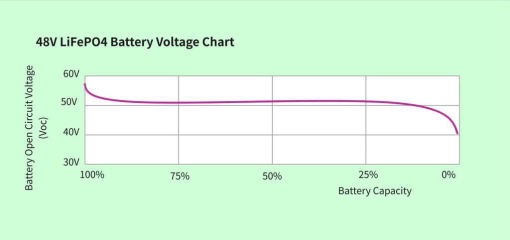

lifepo4 has very close voltage vs AGM, the discharge curve is also flatter. It's a very good swap-in for AGM... non-lifepo4 lithium batteries are a worse match that involves some compromises.

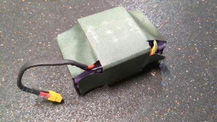

This jibes with my experience. I had over five years and nearly 15k miles on eight 36v 10s2P Li Ion "hoverboard" packs wired in parallel. They've stayed in balance all this time and would still be going strong were it not for getting dragged by a trailer for a mile or so. Even with that, the six surviving packs are still in balance. Each pack has its own BMS.

The only downside to the upgrade is that the meter on the mobility scooter is not designed for the discharge curve that LiFePo4 batteries have. So the meter on my dash is not really accurate at all, it just shows that its 100% full all the time, and then eventually, it will go from 100% charge to 0% in a matter of a half-mile. This is to be expected if you are familiar with the discharge curve of LiFePo4 batteries.
