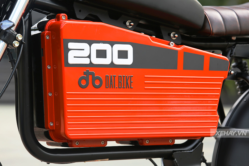

nhattan12 said:
Here is a battery pack of eBike, have properties is 72V 68Ah. Here is a picture outside of pack:
Assuming it's 20S do you realize how many 18650 cells would have to be in parallel to arrive at 68Ah? Do you realize it may be impossible to cram that many 18650 cells into that enclosure. If each 18650 cell is rated at 3400mAh wouldn't it take 20 in parallel to achieve a 68Ah rating. If 21700 cell's rating was 5650mAh it would take 12 in parallel to achieve a rating of 68Ah. If 4680 cell's rating was 8500mAh it would take 8 in parallel to achieve a capacity rating of 68Ah.
If there were four hundred 18650 cells in that enclosure it would be possible to achieve a battery pack capacity rating of 68Ah ... if each 18650 cell capacity rating was 3400mAh (20S20P = 68Ah). Is it possible to cram four hundred 18650 cells into that 72V (20S20P) 200 DAT.BIKE battery pack enclosure that's pictured below ...
What makes you think it's a 18650 battery pack? Even if it were possible the cells are so close together making passive airflow cooling INEFFECTIVE! Furthermore each of the tightly packed 18650 cells may be wrapped in a fiber cushioning sleeve making even forced airflow cooling next to IMPOSSIBLE!
Are you 100% sure that 72V (20S) battery is rated at 68Ah? Are you 100% sure that battery uses 18650 cells?

Still there is the issue: if your cells are getting hot enough to need cooling, you're abusing them. Use more cells, or cells with a higher current rating.
Thank you for your reply.
you mean the best solution is control the power of battery system, right? instead of cooling it first ?
Yes and YES! ... being that passive air-cooling is NO solution and NOT necessary (Just My Opinion). That 200 DAT.BIKE was NOT designed for endurance performance racing, but rather for casual urban use (as you are well aware) with only intermittent peak performance like when passing, arriving at your destination on time, etc ... NOT for competitive endurance racing ... Xception being unlimited budget for buying replacement battery packs :cry: .
Me thinks the actual battery pack is 20S10P with capacity rating of 34Ah. It may be possible to cram two hundred 18650 cells into that enclosure ... thus the name 200 DAT.BIKE ... even so forced air-cooling is NOT practical.

Thank you for reply me !
First, about what type of battery. Actually I don't know what type exactly. I just know it's a Li-ion battery, and 1 image from manufacturer.
About quantity of cell, I think that orange case in the image can contain up to 400 cells. Because I see the dimension of 100 cells 18650 in this video. https://www.youtube.com/watch?v=nRQL_dOb2rU&ab_channel=K%C3%AAnhS%C3%A1ngT%E1%BA%A1o.COM
Also, dimension of Dat bike Weaver 200 battery pack you can see in youtube (estimate).
About battery cooling, I think you're right. Air-cooled in full of battery case may impossible.
And, the word "200" in its name is 200 km maximum distance / 1 charge, I think :))
I'll thinking about it. Thank you so much.
nhattan12 said:
Actually, I'm working for graduation thesis in university. The topic is Air-cooled for battery (BTMS).
I want my thesis realistic, applicable, instead of just on paper.
So, the battery pack in image above is a battery pack of electric-bike company in my country.
I really need your answer!
amberwolf said:
well, the real answer is still that if you need to cool the battery, you are pushing it too hard and need a bigger battery, or a better one.
