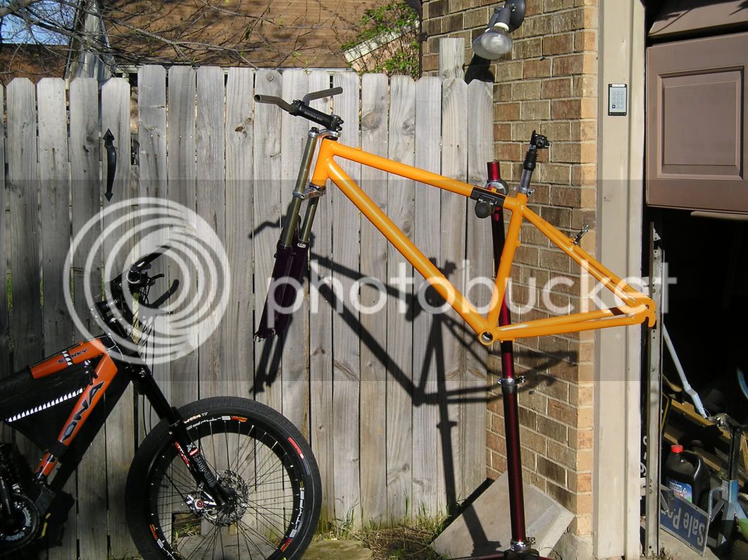

I am helping a friend build an ebike, and his bike has full suspension and disc brakes! Whoa, I thought to myself, a dream come true! But then I noticed that the frame was aluminum, and had VERTICAL dropouts. :cry: Can I use a hub motor on his bike, as long as it's got a torque arm? I am thinking of using a 9C or a Crystalyte 5305. So, I need this thing to be safe as can be.

double up on torque arms,make sure placement is good,if you have room.very safe.
Drunkskunk, does your bike have vertical dropouts then? Also, I'm not sure if I can fit double torque arms. My friend's got a 7-speed gear cluster back there.
If worse comes to worst, he says he's willing to buy a steel front fork, I guess we can look for a used one.
Still, for once I can build on someone else's dollar. Sweet :twisted:
Vertical, up and down, yes. Like the pic below.
1 dropout is enough, 2 is a safety margin. But then 1 wheel braking is enough.

Yep, front end failure can send you to hell before you have time to say OUTCH!
Build in the back, you'll have a better feeling, and safer ride.
