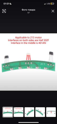

I decided to find out why the motor has 60 deg. instead promised by seller 120 deg. and if it is possible to get 120 electrical (magnetic) deg. offset for the motor hall sensors.
Before purchasing the controller, I asked the seller if their Votol controller would fit my Suringmax motor.
The seller of the controller stated that there no problems, all DD motors work perfectly with Votol controller.
But after I bought the Votol EM50-4 and started setting it up, I got problems with the setup.
To this the seller of the controller tells me that only their QS motors and only motors with the angle 120 deg. of hall sensor are suitable for their Votol controllers.
I was very shocked by the lies of seller. In order to sell, he is ready to state anything.
It calmed me down to think that my motor at least has hall angle 120 deg. how stated seller of motor.
But the controller setting was not successful. The value of 120 degrees in the controller settings did not make the motor work correctly.
Thanks to auto-identification and oscilloscope measurements, I found out that the angle of the hall sensors is other.
I decided to replace them with new, working hall sensors.
And I asked the controller seller what kind of Hall sensors are in the QS motors.
The thing is that my Suringmax motor is a popular motor model that many manufacturers copy.
And QS also makes the same motor.
I found out and bought the whole board with three Hall sensors like in the QS motor.
One more thing.
By the way, to get 60 deg. instead of 120 by turning the central hall sensor, can use only the hall sensors without the board.
The thing is that there are tracks on the board and turning the sensor simply confuses the connection. And this will not work correctly at all.
For offset the angle hall sensors 60 deg. , needs the board for 60 deg.
For example the board for 120 deg. Turning the sensor the opposite way will result in the incorrect connection.

Of course you have to solder the pins correctly to +5v, GND and signal. Simply twist the connection legs of the center sensor, that the face of the body points to the reverse side. As the legs are fully insulated this should not be a problem, they are long enough. But of course, you can change the whole board or replace the center sensor by one with the reverse logic, also.
