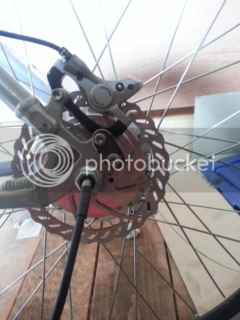

You need one torque arm on the brake side.
http://www.greenbikekit.com/accessories/ebike-wheel-kit-parts/torque-arm.html
Don't use their clamp arrangement. It's unsafe. Do it like this. Either cut down and drill their tie bar or make your own. The metal is very hard. You'll need an angle grinder and cobalt drill, which is why it's easier to make your own:

Also, thanks for the pic of the torque arm. Still deciding on which one to purchase. I don't know if I have the proper tools to modify the one from GBK.
