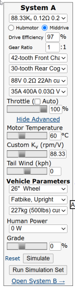

This part is hard.. Trying to find the specs of the motor I got and understanding of this tool is proving to be a challenge.
I made this "custom mid drive motor"
With these settings..
Still playing with this to try to figure it out.
The trip simulator would probably be easier to understand for your purposes
You can use the google maps function to draw a trip on a map and if that map's elevation/etc is correct, it'll give you approximately the power required to do what you want.
I don't think it has a gearing function, but if you use the gear ratio to multiply or divide with the motor parameters you have, you can put them in there as if it was just that. (my wording might not make sense; i'm very tired atm)
