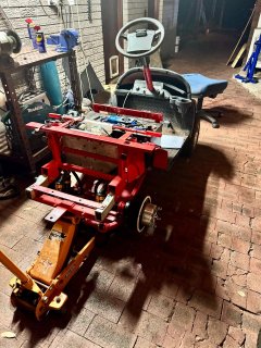

Just took a few quick pics of our current setup which is a platform I had laying around that is also a similar size to a quadbike and does well for testing, but not so cool in the looks department lol.
I'm now in the process of swapping back to Kelly controllers again as Fardriver is geared up for two wheel machines. No 'neutral regen' as Kelly controllers called it and no analogue braking. The main reason for going Fardriver was the hope to get rid of some starting crunch, but no matter what I try I cannot get rid of it, and starting to think its my hub motors. Twin 2KW 48V rated from QS. I'm going to miss not having an iOS app as Fardriver was so much easier making changes.
Looking now into vesc based controllers and will probably avoid the Flipsky as mentioned earlier in the thread.
