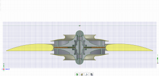

I've been thinking about a ducted circular wing lifter for years, but recently the idea of a counter-rotating coreless axial prompted me to draw one up. Seems to fit together nicely, has balance and symmetry, but,.. does this thing have a chance in hell of getting off the ground?
I know I'm missing like the first law of reality or something, and don't know too much about air speed, wing shape, and lift, so help
me out here. Shoot it down and I'll move on. (lock and load!)
Concept drawing, so no bearings or magnets, and dimensions and details are vague. :wink:

The Canadians tried something similar, called the Avrocar, back in the 1950s. It was supposed to be VTOL, and (gasp) supersonic. It never got ten feet (3 m) off the ground, and it was very slow. They basically invented the hovercraft. Aircraft and rotating masses are not a friendly mix, due to gyroscopic forces. Get a bicycle wheel, suspend it on a string by one end of the axle, and let it hang horizontally (as would your gadget in the air). Spin the wheel, and apply force to tilt the rotating wheel in any direction. Gyroscopic forces will cause the wheel to respond at right angles to any force applied, such as trying to create a bank angle, climb, or dive. Confused yet? Try it. With counter-rotating masses, the gyroscopic forces would equalize, but changing pitch or bank angles would be difficult. Control would be limited, and slow to respond.
The USAF once tried spinning up the wheels of a large plane in mid-air, so the tires would not wear so rapidly (the tire "chirp" you still hear at any aircraft landing). The spinning tires made control of the flying aircraft into a real problem in any banked turn, and as the aircraft changed heading to either side in that banked turn.
Now there once was a "round" aircraft that was to be the replacement for the F-4U Corsair of WW-II. It was the F-5U (Vought V-173), nicknamed the '"Zimmer Skimmer" because Charles Zimmerman was the inventor, and it looked like the flat hat ("skimmer") of the country-club sporty-car set back then. It was the only aircraft I know that had a clutch and transmission. You launched in low gear, and shifted to high gear for normal flight. It was a STOL aircraft, like the German Fieseler Storch, before many people even knew what that was; it took off and landed at a very low speed, on very short runways. It was intended for aircraft carriers. The pilot flew prone, like a hang glider pilot, able to look down, up, and to each side easily. Jets made it obsolete, but it worked as designed. I have always thought it would be a great sport-plane design, with the counter-rotating props, but the machinery needed was just too heavy and expensive. As long as you made the RPM equal on each prop with electronics, an electric version of the Skimmer would be far better than the original. I could even see it as a hybrid, with a small central gas engine turning a generator to power the prop motors (the aircraft equivalent of a Diesel locomotive, having no transmission or driveshafts). The light weight and instant torque of electric motors today would make it practical.
Your idea would be difficult to control, with the reality of the large gyroscopic forces involved. Sorry I don't have better news.

The lift on a wing is generated by moving air along it's surfaces in a specific way within a specific speed range (specific to the wing shape in question, and air conditions present, AFAICR), regardless of how that air movement is generated.
For instance, a helicopter moves the wings in a circle, instead of the way a fixed-wing craft moves them forward.
In your case you're moving air from the inner circumference to the outer one, IIUC--if the air moves in the right way and fast enough to create enough lift, it does the same job.

If you intend for the circular disk to work as a wing, and make lift to carry the vehicle, you would want both of the impellers above the disk, throwing air across the upper surface only. An airfoil shape to that circular disk (as seen in cross-section on either side of the impellers) may be unnecessary, and may even be detrimental. There is no need for airflow under the disk to have a lifting force above it.
Cut a strip from a light plastic bag, half as wide as your mouth, and maybe 10" (25 cm) long. Hold the corners of one end of the strip so the end of the strip is just across your lower lip, and blow a stream of air out horizontally. The strip will rise to the bottom of your air stream, with no airflow und the strip. This is the "lift" you get from air moving above an on object, with no air moving under (below) the object. Your invention should rise like a cork in water. You can test this result with a model using no moving parts, just compressed air from a very light hose, spraying air out horizontally in all directions above the disk. The bottom of this 360 degree stream of air should be just touching the top of the lifting disk.
You would not want the bottom impeller inhaling air from below the disk. Your top impeller would need to have a hollow core, to allow the bottom impeller to get air. Life just got a bit more complicated, there.
You may find that the the lifting disk works better if the outer edges curve downward to some degree, so the air leaving the disk is curving downward as it leaves. Not sure if that will be much help, or maybe a little, but it's a time to tinker.

Awesome news guys, looks like the wing-thing is still flying. (theoretically)
Amberwolf, you talked about airspeed, and I've been struggling with thought experiments on what that might be for something like this. I know there's tons of formulas, and it's been a well beaten path for the last hundred years of course, but not for a circular wing with a smaller central leading edge. The circular wing aspect of this might be a buzz killer in itself.
Not knowing what the impellers output might be, it's looking like there's going to have to be experiments in order to move much further on this.
Looking at human powered flight, I can see that a very large wing surface with very little weight load, does not need very high air
speed to generate lift. They achieve it at a walking pace, so perhaps it will not take that much to make this work. Just guessing,..

Red, I'm shocked to hear that the impeller should be above the disc, (gasp), I've always thought that lift was created from the differential between the top and bottom surfaces. Shows how much I don't know. :confused:
But at the same time, that's good news! Half of the struggle with this idea has been trying to figure out how to get air to both sides of the wing. (I still need some kind of counter rotation though, or it will try to spin like a top)

APL,
Correct, lift is created by the pressure differential between the top and bottom surfaces. Normal air pressure is about 14+ PSI, and less as you get higher. Reduce the air pressure on the upper surface in any way, and you have lift. The pressure of moving air will always be less. There is no need (or desire) to have air moving across the lower surface, really, but you can't avoid that with any normal wing. Did that plastic strip rise up to the bottom of your lung-powered airstream? You made lift, with no moving air under the plastic strip.
All you will get with normal props is a hovercraft or a drone, which only flies by pushing air down hard enough to lift the weight. Slinging air from your impellers across the top of your lifting disk would be a whole different animal.
The advantage I see with the lifting disk is that the area of a disk increases greatly as the disk gets larger. Larger wings can fly slower, all else being equal, and the same would apply to your lifting disk. The "airspeed" above the lifting disk can be slower, and produce the same lift as a smaller disk with faster airflow.

IIUC how this works, to get 14PSI of lift from pressure on the bottom of the wing, you'd need vacuum on the top. ;)
Regarding creating airflow over the top, you might look up Coanda effect, I think it is called. (not sure if it is what you want to happen).
