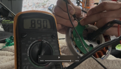

In the efforts of getting as much information to ask for help I took the motor apart and did the following testing:
  • Manually rotated the outer ring and it turns smoothly.
  • I hooked the motor up to power and tested with the throttle and the motor turns with a ‘clicky’ noise.
  • I tested each hall sensor diodes with a multi meter and got values (however I am the first to admit I have no idea what these values mean):
    • 0.909
    • 0.894
    • 0.890
I have attached photos and videos of each test incase that helps.

For anyone else facing this problem, I resolved it by replacing the small hall sensors mounted on the motor. I’m still not sure which ones were broken; my skills are limited so I simply replaced all three.
I took the bike to a shop for a quote on repairs. They said I needed to replace the motor core, which I believe would have included the hall sensors. The total cost was $AUD 540 for parts and labour. I thought I could buy a whole new motor from AliExpress for less so I decided to try and fix it myself. If I completely screwed it up I would just buy the new motor.
I bought hall sensors off aliexpress:
10PCS Electrocar Motor Hall Sensor 3144 41F 43F 413 With High Temperature Insulation Sleeve Hall Element Switch 13A A44E Sensor
I used the technique from this YouTube video to solder the hall sensors to the PCB.
Removing the hall sensors was a bit of a pain, I had to use a heat gun to loosen whatever was sticking them in and pull them out with needle nose pliers.
Hall Sensor Pack was ~$AUD 2.50
You’ll need a soldering iron and a Torx 20 driver/bit to remove the motor cover. It might have been a security or safety Torx head.
Hope this helps someone else if they come across the same problem.
