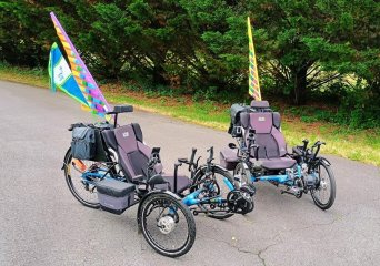

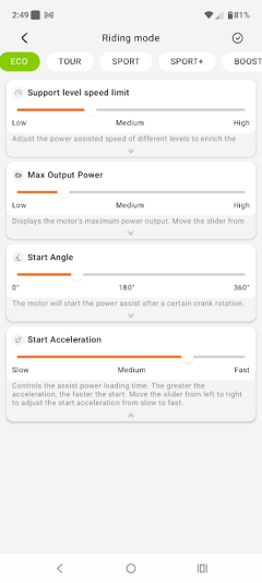

For those of you with a Bafang BBS02 750W Can bus and possibly the DPC010 display have any problems with throttle only, not going over 10 mph even if you choose the max mode?
No one has been able to help over on the Bafang mid drive group and Bafang is no help at all. I am about to blame it on the throttle itself. My PAS works fine.
So I brought the throttle in and connected 6V to it if I am correct it should have put out 6V at full tilt. But all I got was 4.6V. I am considering buying the more popular throttle I see for sale verses this one I have pictured below. And this is the problem with both of our ICE Adventure HD's.
