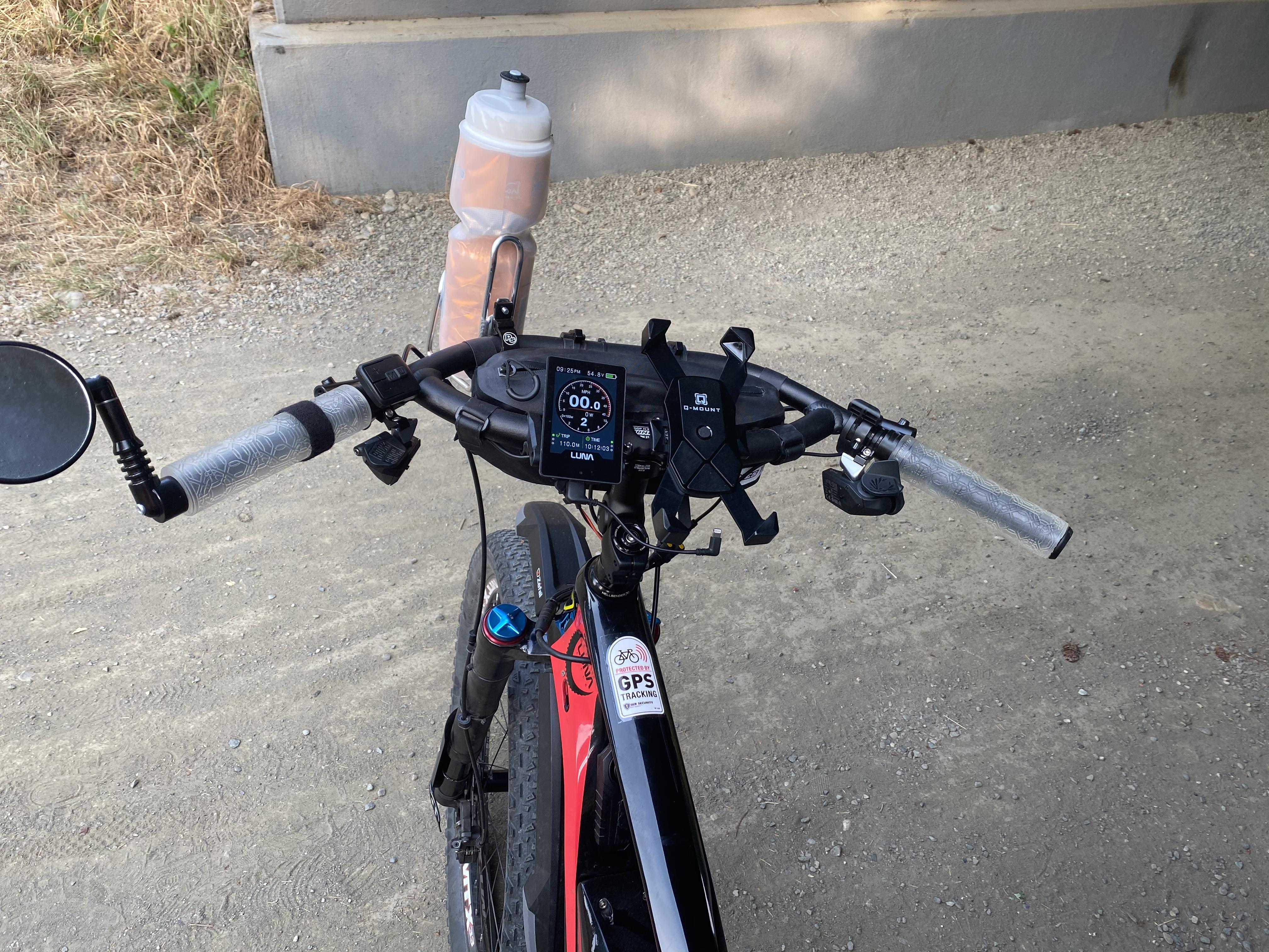

Hi all,
I have a Watt Wagon 2300W replacing my Ludicrous ULtra in a Luna Apollo. I updated to uses SRAM AXS wireless with my 44T 10-50 and AXS wireless dropper as well.
The AXS shifting along with the smoothness of the Watt Wagon Archon X1 motor is awesome. Since the motor does not “run on” at all the upshifts can happen quicker and the downshifts for a sudden stop can be completed more easily. I can use all 12 gears with ease now!
