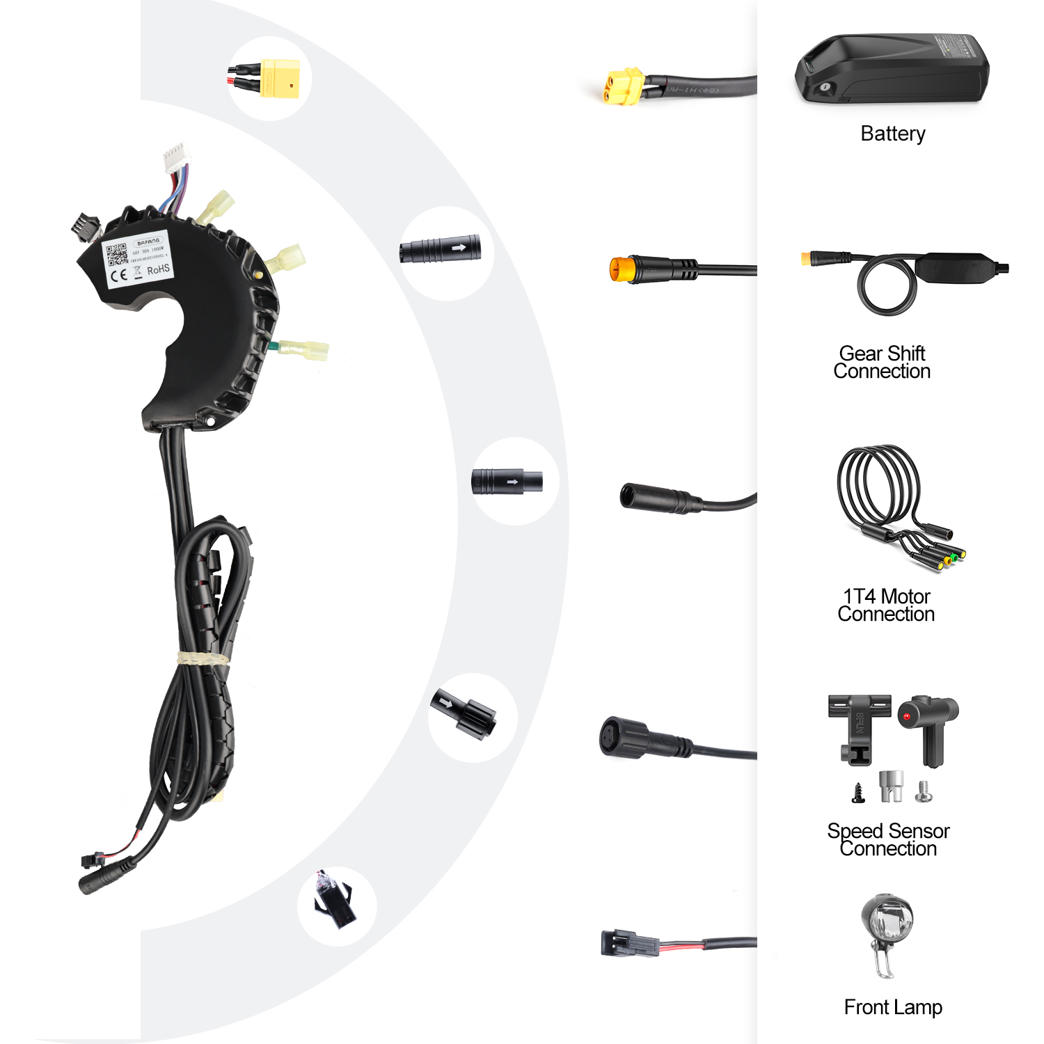

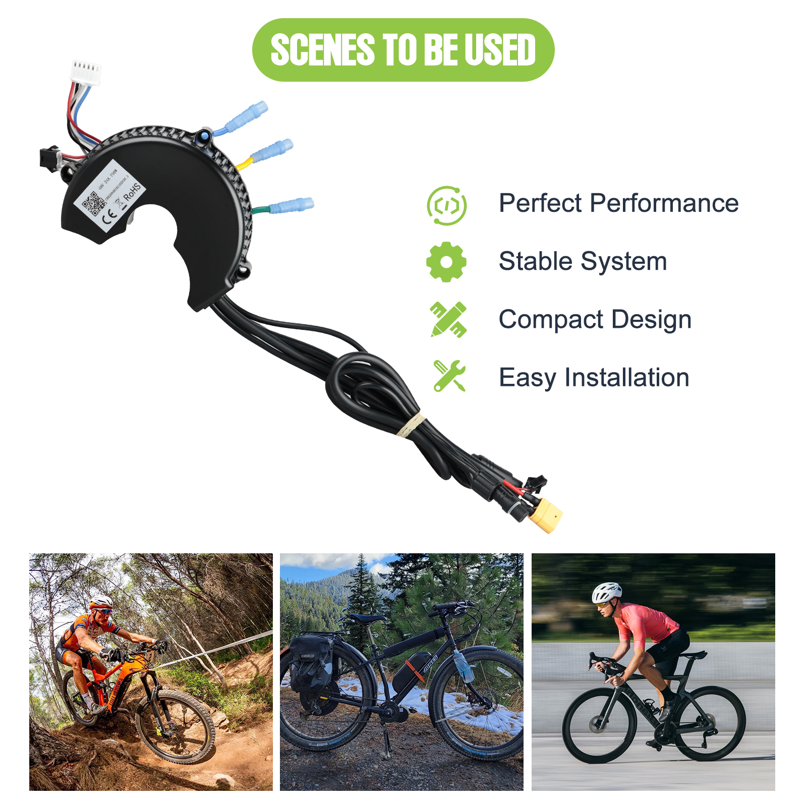

Hey guys I am new, I ride a 28 year old FS Mongoose. It has the standard BBSHD 52V Mid on it. I believe I have found a company that is adding sine wave to the controllers. The reason it caught my attention was the NEW, slow start option without the jerk start. Of course, I have my start amps lowered so it's not really that bad. However, I hope this could be a sine, pun intended, that there might just be a next gen controller out there. I am strongly considering buying on a yet, my buddy thinks it's bs and it's just a stock controller. Could it be possible???? Thanks in advance! Here is the link. I am waiting for their 2nd response as to if by chance a torque sensor was part of this upgrade. Upgraded Bafang Mid-Drive Motor Controller for BBSHD BBS Motor Conversion Kits | eBay
Big Red

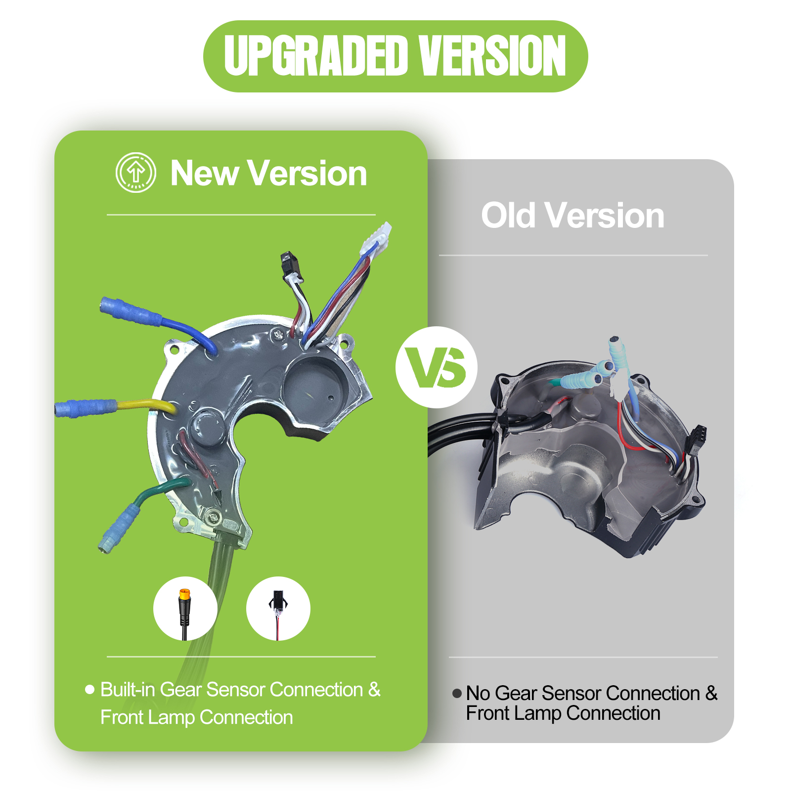

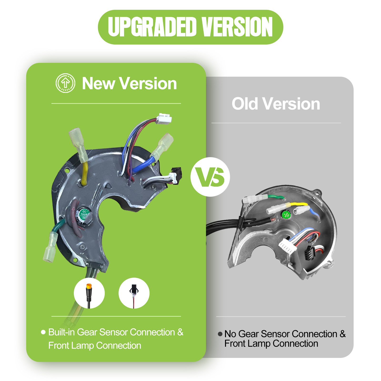

Below are the Item Description images and text from the linked page. Nowhere in it that I can see does it say there is anything different about htis from the standard controller, except two differences it points out in an image, that the one being sold has connectors for a front lamp and a gear sensor.
EDIT: it also mentions an "added slow start function", which has nothing to do with sine or trap drive; all that means is that the controller limits current more than it is actually being commanded to by the user, upon initiation of user command to apply power. Unless that's a user-alterable / configurable / disableable function, it's not really a plus for some systems or users, though it could certainly make the system easier on the gearing, and clutches in the motor system.
As far as sinewave vs trap version: if you do a web search for BBS Sine controller, there are results that say that's what they are. I don't know what difference you need that to make in your system vs the trap drive, though. (it might make it a little quieter, but I expect all the gear noise is louder than the controller)

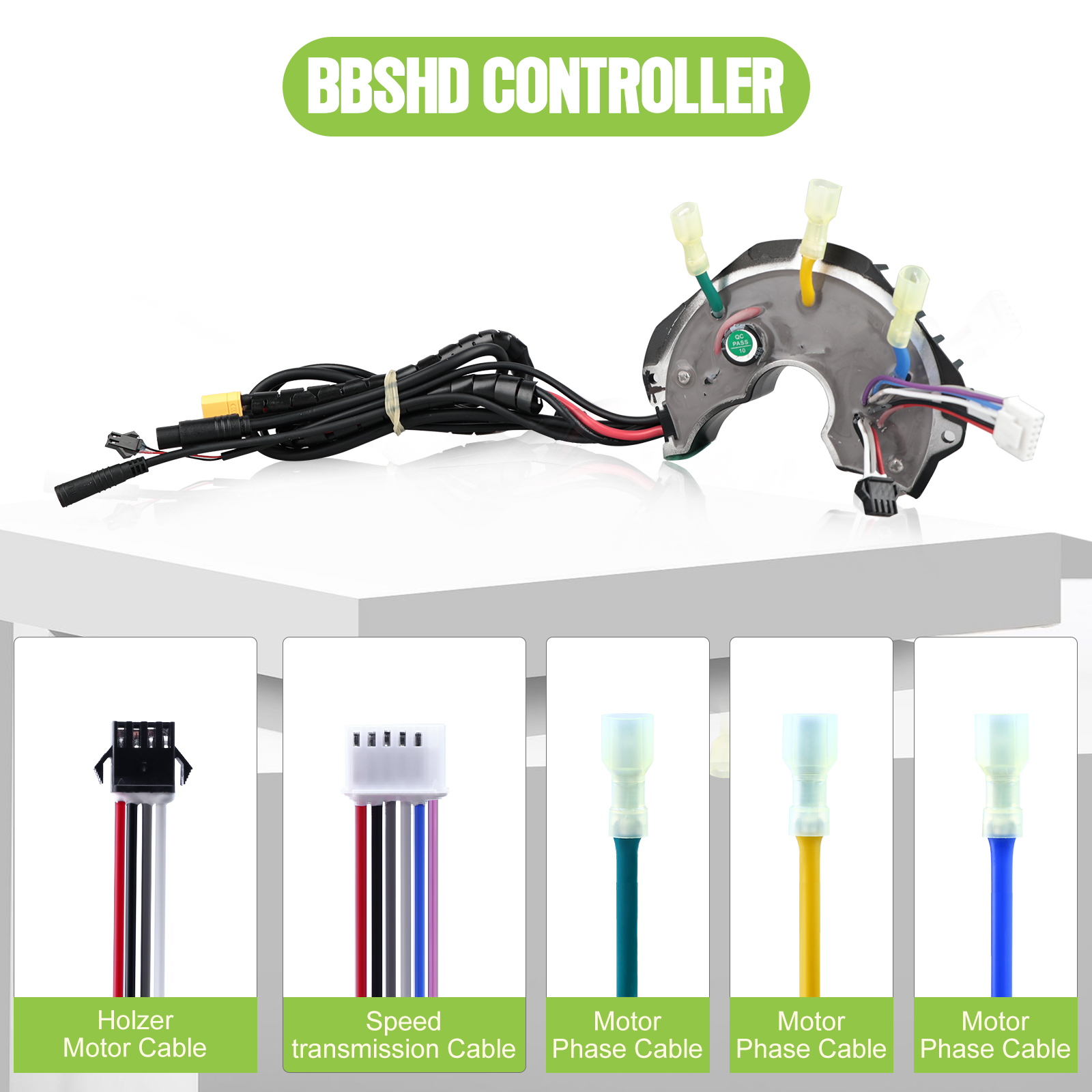

Introducing the 2024 Upgraded Bafang Mid-Drive Motor Controller:
Experience the latest in e-bike technology with our 2024 Upgraded Bafang Controller. This advanced e-bike controller offers a range of features designed to enhance your riding experience. With the ability to set speed limits via PAS settings in both electric and pedal-assist modes, you can customize your ride to suit your needs. The added slow start function ensures smooth starts and consistent power delivery, while the throttle input adjusts power for a smarter riding experience.
Universal Compatibility:
Our Bafang mid-drive motor controller is compatible with a variety of BAFANG BBS series Drive Systems, including BBS01B, BBS02B, and BBSHD mid-drive motors. Please note that this controller is designed for the latest models with gear sensor and front lamp plugs. It is important to check that this controller is not compatible with Bafang mid motors from 2015 or earlier.

Appreciate that @amberwolf ! Yeah, now it is stock. My concern is with added 30amps, might be a bit too jumpy. Interesting though, that is is labeled as a sine on stock, as you mentioned. I have seen others try to replace the throttles but no clear outcomes that I have found. One of the other reasons for the inquiry, is the fact that I am running a 42 front and single 18 in the back. I know this can potentially cause issues with a large enough jolt. Just trying to mitigate any fires lol. As far as the noise, I am really impressed. At least as a stock version, pretty darn silent. I'll keep digging and see what the supplier response with and update. Thanks again as always. :unsure:
What "added 30 amps"?
I did not say it was sine on stock. Can't find anything in this thread that leads to that conclusion?
I suspect you are either not clearly reading what is being posted, or you are not typing the actual words that mean what you intend to post. If you would re-read and then clarify your responses it would help us help you better.
Assuming that you mean that yours is already labelled as sine, why would you be excited about adding that to your system?
What does replacing throttles have to do with any of the things mentioned in the thread?
If you want to replace your throttle, you should look for replacement throttles, not replacment controllers.
What issues?
I haven't read of any fires with these systems in threads here on ES.
If it's already silent, what do you expect adding sine control method to do for you?

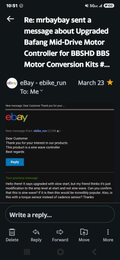

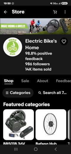

UPDATE: Seller says clearly for the 2nd time that it is in fact a sine wave controller. Apparently, they put this together last year. They have pretty fantastic reviews and looks legit. However, as you mentioned, maybe they always have been? I feel like I want to just give one a go and see iff my buddy can still program and upgrade it. (From 28A to 60A) If it's not then well, lol, I have a new controller.

I have a four year-old bbs02 and that thing is as smooth as silk.
Yeah, mine is not bad at all actually. But, that's with the 28 amps. Now, add another 30 to that and...... I've read about a getting bucked off to the dirt :ROFLMAO:
