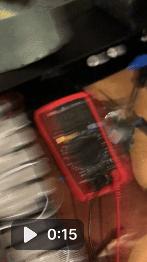

These are correct. But when probing the battery's xt60 output-connectors it shows around 37 volts. No idea why. It should show around 44-45 based on the different cell groups I guess? 3,4*12 = 40,8 + 3,2 = 44. Pretty strange huh?
I think my multimeter is correct. Yeah, all the groups show 3,4 or ,3,5 but one of them show 3,2. Maybe 3,2 might still be in the range ?
All the balance wire from the bms looks like they are still in place. Maybe I tripped the BMS or something? Any ideas?
So what is even more strange. After disconnecting the balance wires from the bms I now get a more accurate reading of the whole battery. Around 43 volts when measuring the main plus and minus going out of the battery.
Any idea why that happens now that I have disconnected the balance leads from the BMS ?
(sorry about the camera - it sucks)
Does this mean I can try to connect the balance wires into the BMS again now? Or would that lead to sparks/shorts or something similar in this situation?
I think it is strange that it now reads 43 volts without the bms connected. But maybe something happened to the bms? I have no idea what though, because it looks fine on the outside.
