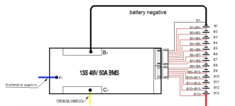

So after disconnecting the BMS from my faulty battery it seems I again get a more correct reading. But it seems the cell groups are now 3,4 or 3,5 and one of the 13 cell groups is at 3,2. Issue that arose with this battery was that it was showing 37 volts of charge, when the bms was still connected. But when it is now separated from the balance leads the main negative and positive show a more correct reading of 43 volts for the entire pack.
Can I use an active balancer, made for a 13s-pack, to charge back my cell groups into balance again?
And after that I could try to connect the balance wire-connector(now separated from the BMS) back into the BMS again?
Or do I have to disassemble the cell groups not in balance and balance every cell individually?

You remove the old BMS and put on a working one.
Look for a JBD BMS if you want to view info on an App, or a real Daly BMS. I believe those Superior BMS are copies of Daly BMS. Popular products, doesn't even matter if they are any good, get copied in CHina,

Great. So now I do not want to do this in the wrong order hopefully. Which cable do you solder on first of the BMS? Do you first solder on the main negative before the balance leads or the other way around? I cannot remeber exactly how this was done when I messed with this in the past.
I guess:
step 1: disconnect main negative of the old bms
step 2: solder on main negative from the new bms to battery main negative
step 3: disconnect charging cable of old bms
step 4: solder on new charging cable to the same output as the one before from the new bms
step 5: solder on balance wires
step 6: check voltage of cell groups
step 7: put the connector from the balance wires into the bms
Sounds all right?
Be careful and don't short circuit anything,
When you check the voltages, make sure they go up in sequence B1-B13, It's very easy to get the wires out of sequence. Take your time, measure the cell tab voltage to make sure it's the right one before you connect the next balance wire.
So I have done the worst now. The BMS is connected and the pack seems to be working fine contrary to before. So maybe the issue was the BMS all along? But now I soldered these wires a bit clumsy so I basically have to have them on top of each other during the first centimeters going out of the BMS.
I am going to place the BMS as the video here. So the balance leads will have to go over each other somewhat in the first centimeters coming out of the BMS. I know this is not ideal for safety reasons to have them cross each other that much. But I think I have to do it if I want it to fit where it is now, on the side there.
The Balance wires were not as long as I first thought, so they will basically have to sit like this. Perhaps I could put some hot glue on them, in the beginning where they are turning a lot over each other? First centimeters out of the BMS. To isolate them a bit from each other. What do you think? Just to make sure they do not short each other while the battery falls off the bike or something. See vid.
It won't be pretty but at least they would not move a lot. And this will not be visible once the case is in place.
I plan on placing/gluing the BMS exactly where it is in the video. Because that is now the best spot inside the case, since the BMS is also rather big. This place is obviously not ideal because of the balance leads crossing each other so much. But could I just hot glue them there to the side perhaps? To make them stick to each other but at the same time not AT each other. So they are separated a bit by the hot glue.
