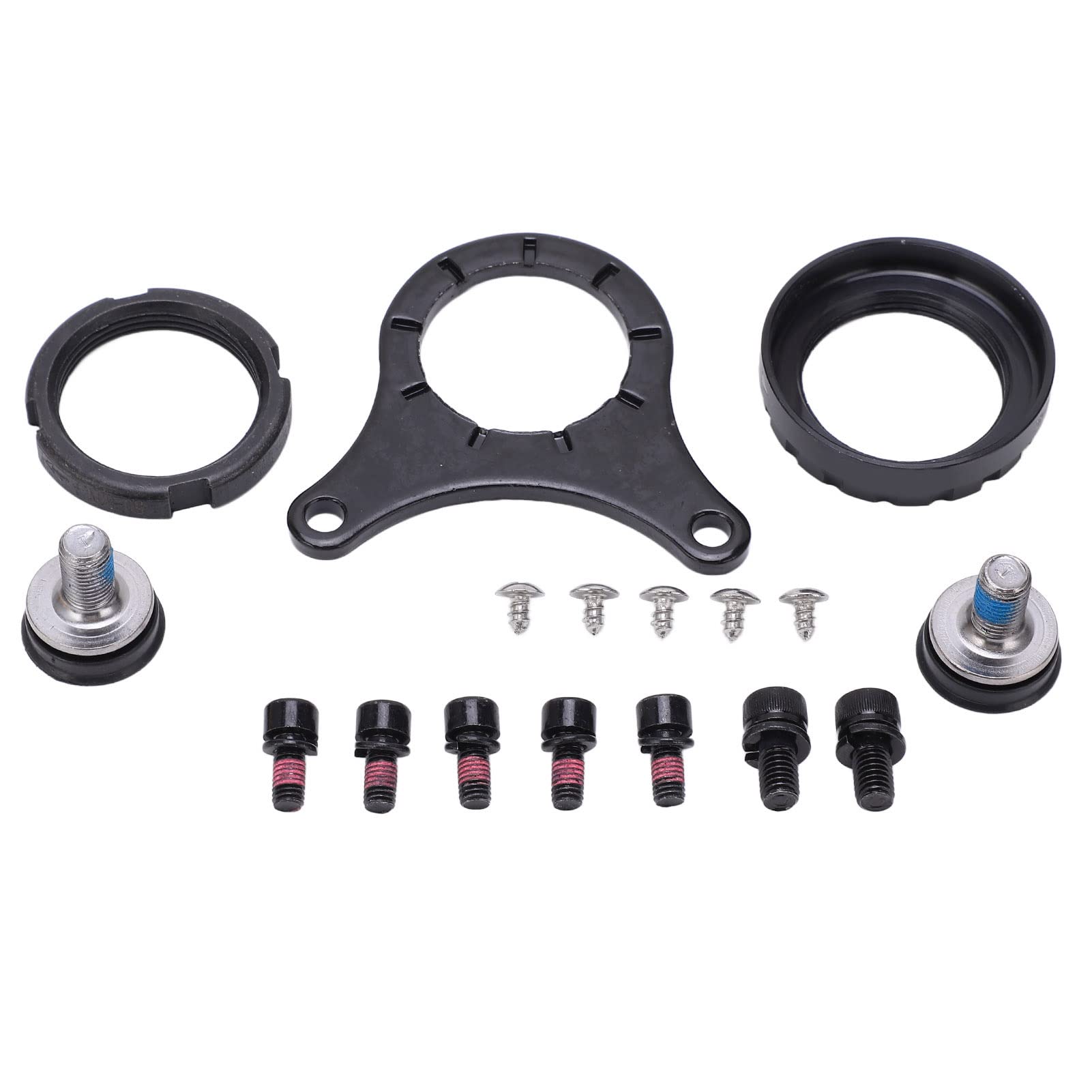

BBS02 noisy when pedaling with motor off
Sounds like you have a problem with frogs in your motor. My BBS02 is pretty much silent powered. I'll have to try it unpowered. It sounds like there is binding somewhere. Does it make the noise when powered?
No, it is completely new and I already regreased it with Mobilith SHC 100 before even using it.
And it is maybe 50 harder to turn the pedals with motor off than on a regular bicycle.
Have you overtightened the nut top left in this image?
I tightened it to 80Nm. That is what Cyberbikes recommends. Luna recommends even more.
Bafang says 60Nm I think, but companies like Cyberbike and Luna say this is not enough to keep the motor in place.
Others have obliterated bearings by overtightening that nut on their BBS02:
https://www.pedelecs.co.uk/forum/threads/bafang-reliability-my-experience-overwhlmingly-positive.47333/post-715920
BB characteristics vary by material and design under compression? My BBS01B is secured using the same nut, and on my aluminium framed bike when I overtightened, there was increased motor resistance and noise. I didn't use a torque wrench - slackened it off a touch and it's been fine for over three and a half years. A grunt and 7/8ths as I recall, I don't know what that is in Nm. And no mallet or hammer. No threadlock either. They're not called "Destructions" for nothing.
That nut presses on the BB shell of the frame, if that's somehow affecting your bearings then you had something assembled wrong or broken. Your advice seems to be to just leave it loose, which makes me wonder if you've ever ridden/ worked on a BBSxx bike before. Most people have to tighten that nut with a hammer to keep the motor from rocking back and forth.

Now I removed the two lock rings inside the axle and this also did not change anything.
Was there anything protuding within the bottom bracket, which needed filing away/flattening before installation? Was it a tight fit?
Have you tried it with the original gear cover? It looks to me like you're going to have to swap parts out until the noise goes away. A chain and rear wheel speed input would allow the motor speed to be more consistent.
Bottom bracket shells are made of metal, and they have elasticity and yield strength. The tighter you squeeze them, the shorter they become. That change in dimension can easily overload bearings and promote failure. I demonstrate the effects of overtightening cartridge bottom bracket lockrings to students in the classes I teach. It's no different with BBSXX except that the forces on the bearings are reversed, outward rather than inward.
