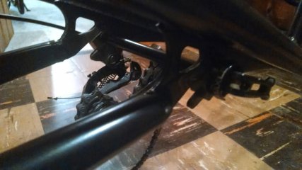

For my first e-bike build I chose a Yuba Mundo cargo bike. I purchased a frameset and 750 watt BBS02 mid-drive from Dan at Ichi Bikes. The first step was to grind off the cantilever posts front and back since I was going to be running disc brakes. Yuba uses 14mm dropouts with bmx hubs. After seeing Sam's (mechanic at Ichi) Mundo modified to use a thru axle I decided to go that route. I made some adapters and had Sam weld them in place for me. A mid drive paired with a thru axle is a good combo since you don't have to worry about the axle getting pulled out of alignment.

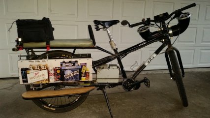

After a couple of rides I decided that all I was missing was some tunes. So, I put a pair of 4" speakers in a pvc enclosure up front and mounted a little bluetooth amp for it on top of the project box next to the DC to DC converter.
Since I decided to keep this project a street legal build and have a 20 mph max assisted speed I replaced the 48 tooth chainring with a 38 tooth using an adapter from California E-Bike.

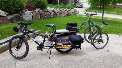

On top of the rear deck is an axle holder for towing another bike. I can actually sag another bike rider and their bike with this setup. The bike is a blast to ride and my daughter has plenty of room on the back even with the bags on it.

cool build! Could you explain or link to what is involved in doing the thruaxle conversion?
For the thruaxle conversion I modified a t-nut so that it would fit in the back of the dropout. I used a grinder and a file to round off half of one side. I did this with two nuts and then had the threads on one of them drilled out with a 12mm drillbit. I purchased the t-nut from Enco. (Model #319-8950 M12 X 1.75 14MM TAPPED GIBRALTAR METRIC T-NUTS) The t-nut with threads was welded to the drive side dropout and the other t-nut was welded on the non-drive side. The axle that I'm using is a RockShox Maxle Lite 135 x 12mm.

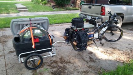

Delivering a bike to a friend.
Delivering a truck wheel withe the use of a trailer.

Adapting a thru axle hub to take a 14mm axle is a really good idea. The adapters should be very easy to make from existing 10mm QR adapters. 14mm nutted axles are readily available (although the length may be a little tricky, try Yuba for one?).
thanks for the axle explanation, which wheels(hub and rim combo?) are you using? Did you do anything special to front wheel
The front and rear hubs are Azonic Outlaw Recoil. Since I wanted 36 spoke wheels with a thru axle, my options were limited. The rims are SUNringle MTX 33. I figured a DH wheel build would be a good choice for a cargo bike. Nothing special about the front wheel other than being 36 spoke.
