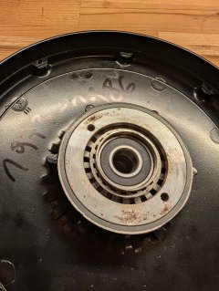

The pics show the interior of the motor, the PCB essentially only holds the three Hall sensors mentioned earlier, two (label HS1 HS2)located center-bottom-right in a line and one (HS3) closer to the center which gives the torque signal(but this is another topic).

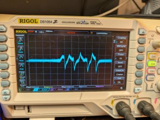

I'll definitely try to go with my already existing torque sensor, i just had the feeling that the signal in terms of quality will need some filtering/processing before it can be sent to an ADC. Pic attached was torque signal by weak hand and about 20 cm lever (AC coupled, offset is ~2.5V)

i attached some images of the open motor.

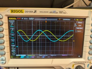

the mainboard in the motor, has not much on it, apart from three quite expensive analog Hall sensors (Honeywell SS495A) you can see three hall sensors labeled HS1, HS2 and HS3. HS1 and HS2 are located directly under the mag. polewheel, which is on the 2nd half of the motor.
if i supply the sensors with 5V and scope the output while turning the motor, you see a analog quadrature (sin/cos) signal (see pic), showing 20 periods within one full mechanical rotation.
My additional blackpill STM32 is now used for AD conversion and emulation of the expected 3-hall-switch-signal.
HS3 handles the torque sensor, different story. Additionally an NTC resistor is strapped against the winding copper, pic top left.
The three large metal parts seem only to be used for mechanical mounting of the PCB, keeping the ability to fine tune the lateral positioning.
