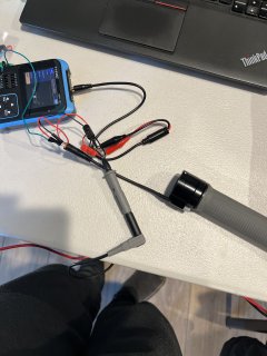

I don't know exactly how this ysstem is wired, but if the actual throttle signal and voltage are inside the cable that was cut, if either was shorted to the battery voltages that go to the display, the throttle coulc've been damaged. Even if it isn't directly shorted if the TX/RX between display/controller were shorted to the battery voltage, and if the chip(s) thsoe go to are powered by the same 5v that the throttle and/or pas are, the chip(s) could've been internally shorted and sent too high a voltage to throttle/pas/etc and damaged them.
Alternately if the brake sensor inputs on the controller are being triggered for wahtever reason, those would also prevent operation.

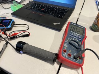

I think you’re right on the throttle. I tried testing it using a 3.3v output from a Temu oscilloscope and verified with the multimeter.
The throttle shows no voltage change throughout its range and just sits at (edit) 2.7 millivolts (not volts) regardless of position - wasn’t paying attention to auto ranging meter.
Is 3V enough to test with?

Update: it was the throttle! Thank you very much amberwolf!
I found the old throttle in the junk drawer. Old throttle showed a range of voltages throughout its movement. Threw it on, connected everything, and we’ve got movement.
Thought I'd quickly summarize symptoms if this happens to anyone else.
My kid accidentally cut the main wire harness of a bafang bbshd wrapping cables. He must have caused a short with the high-power battery wire in it. Symptoms were dead display and nothing worked.
I tested for battery power at the connector coming off the motor and saw 52V. Jumpering the green connector using a Bafang USB adapter and testing throttle did not work. A new display also did not work, so we got a new controller (I didn't bench-test the old controller, but it was at least 4 years old with hard use). After a new controller, the display powered up as normal, but no motor functions worked. The throttle, which has a blue light to indicate on, showed it was getting power.
Bench testing the throttle revealed that it wasn't working - the potentiometer was not potenti-ing or whatever. Reinstalling old throttle made it work fine.
I think the cut in the wire caused the 52V hot wire to fry everything, an expensive lesson.
