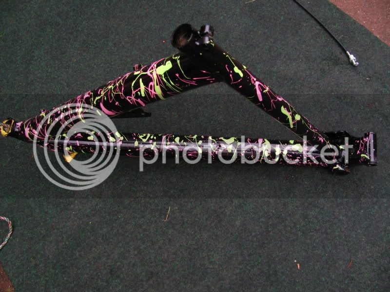

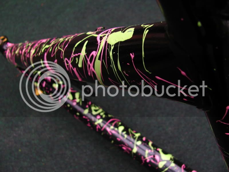

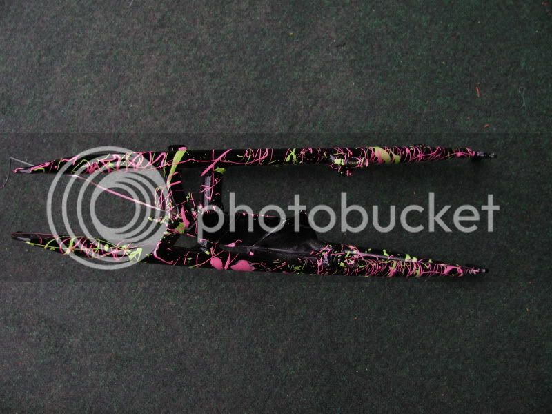

I painted the bike last week. As I already posted before: black, green and pink ghehe
It should look like this if the first 2 parts are mounted to each other:
I think most people will find these colors gay and stupid, but as this is a BIRTHDAY E-Bike it suits well imo :mrgreen:
vanilla ice said:
Straight outta 1988.. nice!
Hehe, yup! :mrgreen: I wasn't even born at that time (born in 1993) but I like the colors they used back then :)

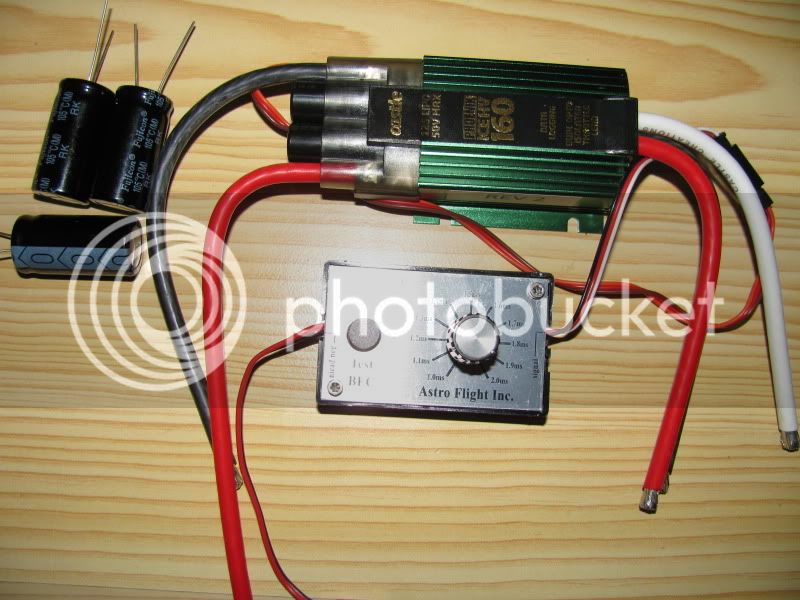

Got my CC ICE HV 160 and Astro Flight servo tester in a few minutes ago. I will solder some 8mm bullets on it tonight and also the 2200uF 63V caps. The ESC is way smaller than I thought it would be.
I also got 16 meters(!) of white braided sleeving and 5 meters of white heatshrink. I'm still waiting on the Magura throttle I bought 2 weeks ago...

Could you elaborate the usefulness of the capacitors. I am in the same boat with going for the ICE160hv.
Why are the capacitors necessary and what specs are ideal? As big a possible?
I could imagine reduction of tensionspikes is the reason but I dont see how they appear etc.
I have seen posts about that the positioning should be as close to the ESC as possible.
You need to change the 160 parameters to "Airplane Fixed Endpoint". This eliminates the need to calibrate every time.
Wheazel,
Yes, the servo tester provides 1-2ms pulse to the ESC for throttle control. You also need a 5v power supply to power up the servo tester. The stock potentiometer is removed and the Magura wires are soldered in place. This setup works very smoothly and accurately.
Matt
Wheazel said:
Interesting project, looking forward to this one in action!
I'm not a tech-kid myself, but Ron van Sommeren explains it really well imo:
ron van sommeren said:
Battery wire inductance is the main cause of problem, not wire resistance. The wire-inductance causes spikes on the power input. Long motor wires is not a problem. If you have to use long battery wires, install extra caps on the brushless controller. Reasons, explanation, methods, manuals, suggestions for installing
http://www.rcgroups.com/forums/showthread.php?t=952523
You're right about the caps should be as close to the ESC as possible, most people advice using low ESR caps.
Regarding the throttle, this is a useful link for you, it helped me making mine, it's from Recumpence: http://www.endless-sphere.com/forums/viewtopic.php?f=28&t=12196&start=0 Everything you need is written in that topic.
@AJ, BB and Recumpence; thank you for your input guys! I'll try all the things you said to eliminate the 1/3 dead spot and not to calibrate every time. This forum is so helpful, I love it. Thank you! :mrgreen:

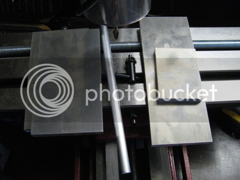

I also got a new workspace, my grandparents offered this to me. It's not big, but I love it. I also received the cross table you can see in the second picture, it's a heavy thing. Costed me about $130,-
And I received my 7075 aluminium, all pieces are 12mm thick. This stuff was expensive: $80,-
I will start working on the aluminium in a week (I'm busy now).

Congrats on the workshop space! There are many that don't realize what they have, if even just a garage. Did they also provide you with 3 cases of beer? Gotta love the G parents! Looks like you have some big chunks of Aluminum there, that stuff sure does get expensive. I'm lucky enough to have a supply house near by so I get remnant pieces for a decent price. I'm interested to see what that cross slide drill press can do. :|
I bought the cross table just for moving the aluminium so I don't have to re-secure the pieces of alu everytime I need a new hole. It's A LOT more comfortable to work with this cross table, I only have to secure the aluminium part once. :)

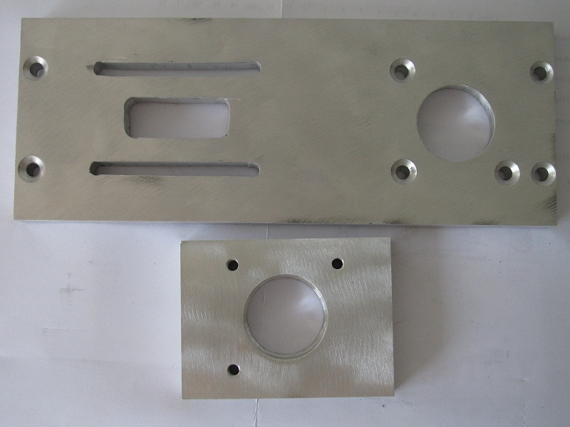

Anyway, after 2 months finally a update! After LOTS of hours of measuring, drilling, dremeling, filing and so on I came to this result. The aluminium 7075 is really strong stuff by the way! It's not finished yet, I need to make 3 pipes from aluminium to secure both pieces of alu with the 3 screws you can see. Also I need to drill out the bore of the small sprocket so it will fit the 12mm motorshaft and ofcourse I need to make something so that it can be mounted on the bike. (But I'm very busy with school, so it could take a while till I get that done)
Both pieces
If you look closely you can see that I left just a little aluminium in the big hole so the bearing won't slip away.

Is there a plate to connect the motor plate to the plate holding the little cog on the jackshaft?
I'm not sure that the bolts I see will be up to the torsion loads imposed by the chains. Even a thin plate of aluminum like 4-6mm would make a big difference.
Lots of good progress there. For a drill press and a cross-vise no less.
How did you cut the recess for the bearings to fit properly?
Katou
