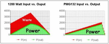

In these side by side charts I've calculated the power
output verses what is "wasted" on the smaller 1200 Watt
motor verses the larger PMG132. They both produce the
exact same output.
The "waste" is in red:
One thing to keep in mind is a bigger motor generally has a higher no-load current. This means at low power levels (riding slow) a bigger motor will have higher losses. An Etek motor takes about 6 amps just to turn over. My MAC BMC motor takes about 2 amps. For a given maximum power level (ie, max top speed) there will be an optimum motor size.
For a sub-30mph machine, a Crystalllyte or BMC motor will be more efficient than a Perm or Etek. If I want to go 45mph, then a Perm will be better.
:arrow: This is all true.
The bottom line on electric motors, both in an industrial setting and a electric vehicle setting, is to match the desired load to the more efficient part of an engines powerband. The "ideal" motor will have it's "peak power" and "peak efficiency" at the same rpm and the load matches your desired load, this can only be done by getting the size right and the controller limit right. If you then have the controller perfectly set to that peak rpm as your current limit you get a straight line for your power curve (rather than a parabola) and the efficiency stays near the optimum for a large part of the powerband. That's the best that electric motors can achieve, near "perfect" power across the entire powerband, with little losses.
My point of this thread was to "expose" as a fraud the idea of increasing the current limit as the best way to get more power. It's just not true. If the motor is undersized for the load you want to pull then increasing the current limit just translates into more waste. In the "worst case scenario" where current is allowed to go above the peak of the "power parabola" you are literally throwing energy away in the form of heat with nothing to show for it. (and you might blow up your system while you're at it)
