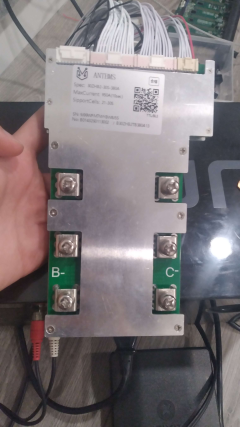

I'm planning on getting this BMS. The 400 amp continuous version is 2cm shorter than the 420 amp one so I will probably go with that one but its still about 3.5cm longer than my battery is wide.
My original BMS I bought is the 17-24s version of this one. Guess I'll have to build another bike🤷‍♂️

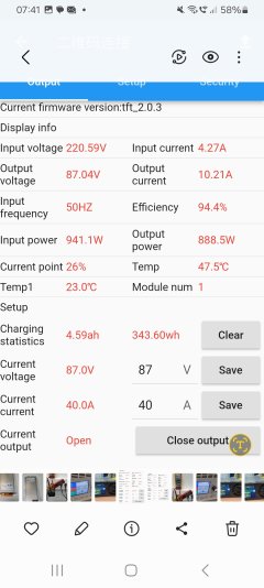

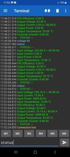

I measured on mine 97% efficiency at 3kW charging power.

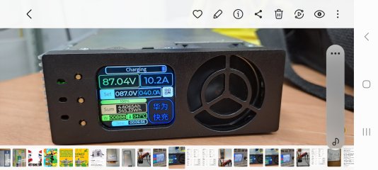

Can I adjust the voltage on the Huawei? It has a note to tell them your voltage and desired current so they can modify it. I'm willing to spend a bit extra for reliability and efficiency if I can adjust it to work on any bike I have.
Also, I can only find R4875G1 chargers. Is that the same thing? Does anyone have a link to a specific one?
Has anyone tried this one?
It looks like the one Electro and Co uses. I would guess they're just rebranding it. This is the one on their site:
Sorry for the typo. R4875G1. Mine has a Bluetooth connection to the phone and can be adjusted from 72-103V. They also make a version that goes up to 120V.
there also exist versions with manual adjusting.
They are not intended to use as an onbpard charger.

Do not buy a hiawei that can go from 0-120V. They are heavy modified inside.
The others only have changed the output transformer, output condensator and a few resistors and do the voltage and current adjustment via Can-Bus inside.
As it is done in the original ones.
The only thing Mine does not do is input current limitation. I know the Huawei can do this as I have programmed it already on 30 modules or more. But on the modified ones they must have programmed it wrong.

I would go for something like this, as they still use the normal controll and protections from the Huawei pcb.
The normal Huawei control voltage is 58.5-42V.
58/42=1.4
118/84=1.4
So they use the original voltage setting commands via CAN-BUS and have not done big changes.

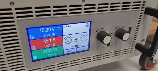

I also have a modif ied Delta PSU as mentioned above (and a lot of unmodified Delta, Vertiv, Eltek, Huawei and Meanwell PSUs in the 1-4.3kw range). The modified Delta is bigger and louder than the R4875G1.
Efficieny from the Delta is 90% and below on lower voltages. The Huawei has nearly 97% from 1-3kw output power on 230V mains.
I test every psu I buy with an electronic load and other nice Equipment.

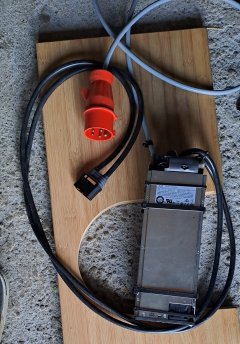

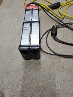

With 28s can also use two unmodified telecom rectifiers in series.
I had used two Eltek Flatpack S and two Eltek Flatpack 2 He, also Vertiv R48-2000E3 and two Huawi R4875G5 with good experiences, i have used them Single phase, two phase and 3-phase , up to 10kw charging power.

Ok, Im figuring out wiring, I made a crude model of the BMS and some beautiful mouse drawn wires to help visualize.
Im thinking I'll use 3 separate wires to carry all the current in the battery. This works well with the post set up on the BMS and would reduce the overall thickness since they can lay next to each other.
If I use 8 gauge wires, that gives me a total of 25mm2.
The wires on the motor say 20mm2 which I think is about 4 gauge, and I'll probably run 4 gauge for everything else outside of the battery, but I definitely want the battery to be the last thing to build any heat.
What do you guys think? 8 gauge or 6 gauge? (25mm2 vs 40mm2)
