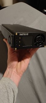

BTW, I just got one of those 4875G chargers. It's awesome! 👍 Exceeded my expectations in every way. I got a 66-93v version so YRMV with the higher voltage version but this thing is seriously powerful. I haven't yet tried to run it on 240v but it can blow the 15A breaker in the garage on 120v! The Bluetooth functionality is nice. It allows you to monitor the input current so you won't overload your outlet. It's a beast!
