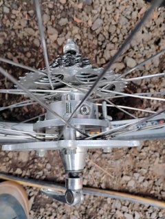

Some clever solutions going on, especially the 85T sprocket adapter
Thanks, you probably recognize most of the parts on that hub, but I'll describe them for anyone wondering.
The split hub clamp is one you find commonly on 49cc gas bike conversions, this particular one has a considerably broader shoulder to clamp around the hub than the typical adapter you find, it also has a nice large flange to get sprocket bolts over the hub flange.
If you look closely, you will see Mike's trademark logo from LightningRods, laser cut into the sprocket adapter, I purchased this from Mike at lightning rods last year, quite economically too.
This adapter was originally meant to bolt onto an ISO six hole disc brake hub, but I've been having a heck of a time finding a 20-in wheel with a disc brake hub.
It just so happens that the bore fits perfectly concentrically on the tapered left hand end of the wheel hub.
The 85 tooth sprocket is a standard #35 chain, go-kart/mini bike split sprocket, with mounting holes on 5 ¼ inch bolt circle diameter.
I drilled and added 2 bolts on both sides of the split to prevent misalignment and chain derailment.
