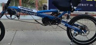

Blue Dream: Maxarya Ray 2 Semi Recumbent w/high eff mid drive

I've always known that a downside of this bike was that it has two chains. This means i probably have double the friction.
With the mid drive installed, we have 3 chains. And chain #2 and #3 spin ~25% faster than the front chain, so they have more friction.
Looks like high end lubrication could improve the efficiency of each chain by about 1.5%. Since these chains are in series, these gains in efficiency get compounded 2-3 times.
screenshot_20250601_1404-jpeg.371015
If these friction losses multiply up as the power goes up, and i move to an ideal lubricant, i may be looking at ~50w of extra power, which is pretty substantial and worth doing due to the low cost.

Reducing crosswinds by going to a more aero shape is more important than absolute low weight.
So here's what i picked after looking at rim weights and shapes for hours.
Front rim ( 20" )
~40g less, 8mm wider, ideal aero shape for crosswinds: LOWPRO RIMS - $70
Front TPU tube
100g less: https://www.amazon.com/RideNow-Fatbike-Ultra-Light-Puncture-Resistant/dp/B0DDXHLWJV?th=1&psc=1
Rear rim ( 21.75" )
~120g less, carbon, rated for 300lbs rider, slightly less width, slightly better crosswind/forward aero: Speedline Parts | Slashers OS/20 451 20x1.75 Carbon Fiber BMX Rims - $240
Rear tire ( 21.75" x 1.85 )
335g less: https://www.danscomp.com/tioga-powe...ck-20-1.85-451-iso-r9za1351/p1417923?v=943540
Should make for a 595g or 1.31lbs less rotating weight, better aero, the better rim to tire size match should improve rolling resistance a hair too. The bike should accelerate significantly faster.
Increased NVH on the rear makes me nervous. 1.31lbs less weight, a carbon rim, and a smidge larger tire diameter might not completely make up for the effects of a ~19% air volume loss. I think a 10mm taller rear shock and the pendulum pedals pushing me 7mm forward on top of this should fix it. So maybe this is not such a big deal.
What i don't like about this plan is that there's no tire larger than 1.85" for the 21.75" tire size. I'm walled in.
in 22" land, i have way more choices, including motorcycle tires.
The next move up to a 22" wheel looks like:
Rim: +60g: https://www.modernbike.com/alienation-vandal-tcs-g69-22-tubeless-rim-457-x-31-36h-black
Tire ( 2.3" ): -70g: We The People 22''overbite tire
This should give me equivalent air volume to my current 20" x 2.5" and improve rear NVH due to the diameter.
All additional tricks stack on that and could provide a surplus of comfort to explore speeds beyond 35mph.
But the extended swingarm is a requirement.
Ultimately i think this bike could use a boost in speed rather than a surplus of NVH so i think the 21.75" is the way to go.
I also think it would be a bad idea to improve NVH too much because then i'd be tempted to build a 40mph machine instead of a 35mph machine :)
Any thoughts?

Decided to do an experiment today and set the seat all the way back and did 8 miles of hill climbing up an average 2%.
Because i know this will rear bias my weight, i also let approx 5psi out of the front tire and shock.
I took off the front bag and crosswind stability improved massively. I need to rethink my storage.
I was able to pedal from a stall and hold 23mph for half a mile. I only gained 1 mph.
I think my loose clothing is holding me back from realizing higher speed. But that speed is pretty good for a clydesdale 😅
Down a 0.5-1% grade, the bike is terrifyingly fast. I'm riding the brakes a bit and not daring to pedal, keeping it below 35. Maybe a little too aerodynamic :eek:
NVH was barely tolerable on a 90PSI rear tire. The front was quite jittery. This is no surprise, but it's improved notably since i went to a semi fat front tire.
A few serious irregularities on the sidewalk at a mere 15mph felt like they nearly pinch flatted both tires, and actually upset the rear ( this is hard to do ).
Super concerning.
The bike needs better bump compliance, especially in the rear, where drama is more dangerous than on the front. This experience cements my choice to use 22" x 2.4" in the rear over the lighter 21.75"
I'll see if i can get some more weight off the front wheel. I believe it's possible, and a lot easier knowing that an aerodynamic shape doesn't matter as much for defeating crosswinds. 200g still matters, and it is worth doing.
Regardless of the issues, it was a fun ride. I was climbing 7-13mph the entire time,
Going downhill in fully laid back mode without regenerative braking and poor NVH is for psychos, so i'll be moving the seat back to the middle position so that i have less of both problems.
Another problem with maximum recline is that the handlebar doesn't have enough reach.
You can't lean back fully due to this, otherwise it's too hard to steer the bike.
Yet another problem with maximum recline is that the bike is hilariously unstable until you hit 7mph. You have to hold the outer edges of the bar to get good stability... or you are not getting started from a stop.
The idea is the same on semi recumbents as mountain bikes. The wider the handlebar position, the more leverage, the better the control at slow speed.
During this ride, i had really long handlebar grips that forced my hands inwards, which caused me to hold the edges of the bar for slow speed stability, at the expense of not being able to grip the brake.
I cut a little over half an inch off, and now with my hands on the edge, i can access the brakes and also the ideal leverage point.
Should improve low speed stability in maximum recline, and slightly improve it in medium recline ( not that it needs it )
I think maximum recline is only unlockable with a +13mm rear shock upgrade, the pendulum pedals getting me 7mm forward, and the longer swingarm reducing drama in the rear end.
