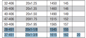

Size chart from Cateye Japan covers these odd sizes and their diameters.
The Maxarya will accept a standard 20" x 3.0", which i don't have a diameter for. So we have to compute it.
From a .7 inch difference in tire size on the above chart, we see a diameter change of 115mm
1.95" + 0.7" = 2.65"
2.65" + 0.35" = 3.0"
115mm added diameter x 1.5 = 172.5mm added
Therefore the 20 x 3.0" tire should = 1737.5mm total diameter ( assuming that these values scale linearly )
Looking at the 451mm rim, we see that each 0.25" = a 70mm diameter gain
A 1 5/8" tire should have a diameter of 1685mm.
If we make that a 1 6/8" tire, we'd be at 1720mm. ( add 35mm or half of the 70mm diameter gain )
This translates a ~22" x 1.75" tire, with a little space to spare. Not bad!

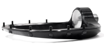

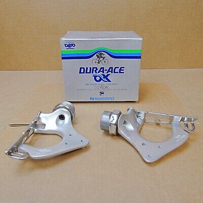

As for this front 20" x 2.8".. i think it's a keeper.. i won't reduce the size of the tire unless i find that i have issues with the pendulum pedals, when they arrive.
