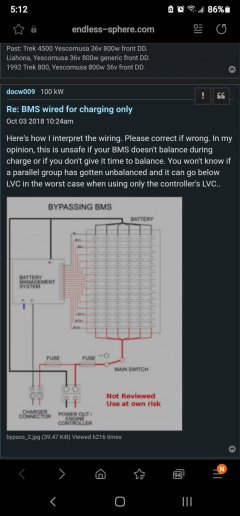

Hello, I'm building an escooter and battery. Qs260 v4 8000w hubmotor,and spim08hp cells for right now to get me started. My question is about wiring a common port or separate port bms for charging only. I have a wiring diagram for a separate port bms for charging only. Just run a 2nd wire from the battery b- to the main discharge plug,that is suppose to bypass the bms for discharge. Is that correct?
Could I do the same for a common port bms? Have the C port and the battery + wire go to the charge plug. Run a wire from battery - to bms - and run a second set of wires from the battery+ and battery- to the main discharge plug?
I'm running 20s 1p right now but when i wire this up and figure it out I'm gonna do 20s 4p or 5p.
