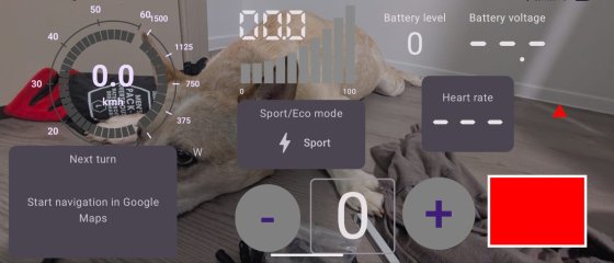

Now it worked, I've just build a quick and dirty dashboard, but of course I have no connection to a motor. The map shows nothing also...:unsure:
Well at least it installs now!
The map not working is likely because I broke the API key trying to get the silly thing to build an installable app. Google's bizarre default setting for Google maps without an API key is... To draw a blank window and not tell anyone about the error.
I'll resolve this as I think the mapping is one of the most useful aspects of this app. But beware that it's not SUPER functional just yet (I really only opened this thread to find out if I'd missed any protocol docs that would make the rest of the coding easier). Give me a half hour and Ill update a functional one, assuming no major issues.

The map is shown now(y)
But you should offer some pre built dashboard layouts, finding just an empty screen when starting the app will cause irritations for users with less technical affinity ;)
Oh I absolutely agree, I plan to have a list of them pre-prepared. (You can pretty obviously actually copy legitimate hardware displays with the correct widgets too, but I'm avoiding that to prevent any issues)

Note that if you want to actually USE that board, you need to send it a set baud command appropriate to the motor you've connected it to. I can give details, but they're also documented in the README.md
edit: Just to add, the whole build system seems a little odd to me, at no point in the sources or the visual studio config does it store the output boards. You literally need to configure them manually or run the build script. Once the script is run, you will be able to build/debug/flash (depending on board) directly from the IDE
Also! I feel I should note that originally that project was me seeing how good Claude was at one-shotting a project where the correct methods to do everything were unambiguous and available to it. That initial, almost fully working version, took 22 minutes of AI magic to create, and I am pretty sure it worked perfectly (I didn't test until I added the baud-rate setting code so I can't guarantee it). I was amazed. I didn't expect it to actually function.
I have written absolutely no code in that project. It just occasionally needed a push in the right direction.
Finally! You might notice the bluetooth LE handling is a little bit odd. It absolutely is a little bit odd. Usually the nrf board would attempt to initiate encryption/transport security. This lead to some very predictable but strange Android behaviour. It would work, but only on the second pairing request. The first one just got lost.
So now all encryption is initiated from the connecting device's side. See PAIRING_PLAN.md for details.
And obviously the preponderance of .md files are mostly me telling Claude to remember/document the findings from any particular thing. They're not particularly readable as you've seen!
