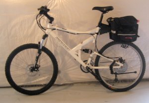

I have the BMC 600 watt, but have not experienced weather conducive to extensive testing yet this year in the Chicago area. I'm using it with a the same Crystalyte 40A controller as Dirt dad (Stock MOSFETs) and a Ping 48V20Ah battery. Around the block testing shows this setup is good for 30MPH.
The power wires to the motor seem a bit wimpy, but they are pushing what I think is 3 phase AC to the motor (right?). AC wiring does not need to be as heavy duty as DC.
I bought it the guys at www.hi-powercycles.com, who seem knowledgeable about their product and are striving to deliver a high performance product.
I like the fact that you can put an 8/9 speed cluster on the hub, and that a disk brake bolts right on. hi-power installed the 9 speed cluster for me. I like it because you can't tell it's an e-bike.
Cranking it up in the basement with the brakes on I saw a max of 80A on the CA, but that was with the shunt value set to 1.0. I have now set it to 1.2. I'll post more stats when I can take it for a real ride.

Ok, FINALLY the weather coorperated enough for me to ride the BMC 600 e-MTB with Ping 2.0 48V battery to work and back. 30 degrees F in morning (frikkin cold), but it warmed up to 70 F on the way home. The ride is about 7 miles each way, in and out of a river valley, city traffic.
So... round trip stats!
Amp hours used: 15.65
Watt-hours: 724.43
Watt per mile: 44
Negative or regen current: -16.9 A
Max current: - 79.66 A
Minimum voltage: 26.5V
Max speed: 34.4 MPH Average speed: 24.1 MPH
Trip time: 40m 59s
The bike cruised at or close to 30 MPH, went up hills around 25 MPH, and accelerated quickly. Very nice. While the bike doesn't go faster than my 24V e-recumbent, it does get up to speed MUCH faster, and goes up the hills much faster.
