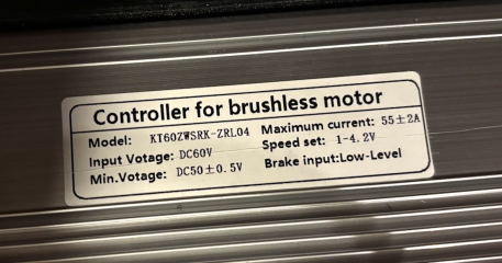

I turned the throttle (without pedaling) at a red light and bike just died. I do not know if it had something to do with me blocking the pedals causing sudden extra peak that made it burn or something. But could have! In the display, I have set it to 50% power, just so you know.
This is the kit i ordered from Leafbike: https://www.leafbike.com/products/d...ike-conversion-kit-1355.html?VariantsId=11264
60V 2000W with LCD03 and it runs so great, when it works. hehe.
So I contacted Leafbike support which answered quickly and gave me great instructions on what to try, so I started to troubleshoot the controller and I had friction in the motor when turning it by hand. I can just describe it as I "felt" the magnets inside the motor when turning it.
I do not know much about the electronics, but I did it like this:
Connected ONLY yellow phase -> no friction
Connected ONLY green phase -> no friction
Connected ONLY blue phase -> friction
So I just ordered these mosfets: https://www.aliexpress.com/item/100....order_list.order_list_main.11.24671802UHRzrl and replaced all mosfets on the blue phase. This removed the friction. So I thought I had some success, but turning everything on again and twisting the throttle resulted in the same error as before "E06 Info" on display, and no turning motor.
So currently I am out of luck. I do not know what more to do here and I don't wanna just go and buy a new controller before I have tested everything I can here!
I hope anyone here can give me some advice
