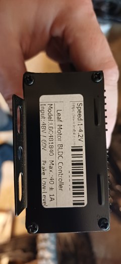

So I got this 1.85 - 19 inch 48V 52V 2000W rear electric motorcycle motor kit. I am trying to make a hybrid from a Leaf Bike gearless motor and a Riding Times GT73 frame.
Installed it on my GT73 frame just bare minimum batteries, hub, controller throttle and the screen.
Problem I have it just jolts for a fraction of a second and cuts the power, if I try to push throttle just a bit it works for a 1-2 sec and cuts the power. After checking with support tried senseless mode and the throttle worked! Just I needed to do the push to start the whole bike...
Support told me there is no E07 error so most likely the problem is with the controller. I though the hall sensors are bad, but I am no expert in this field.
They said they check everything before shipping but mine doesn't work for some reason.
Maybe you have any ideas what could be wrong with it?
