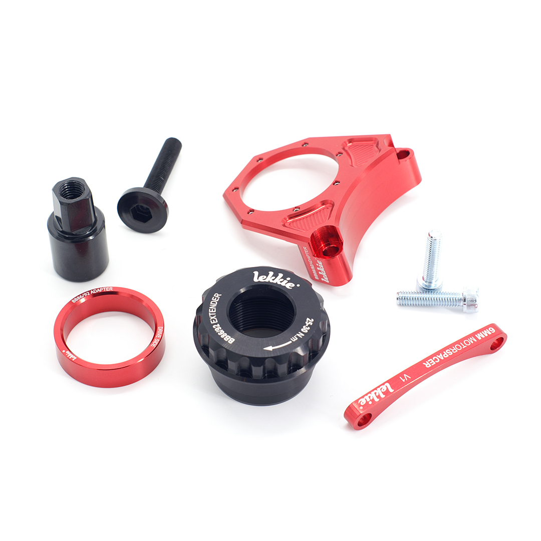

Any experience with this adapter kit? Would allow for installating a BBS02 68/73mm on a BB92 bike. I am about to buy a Giant Anthem. The specs says Praxis BB90 PressFit, but I think I've seen people using the BB90 shell adapters on them with a BBSHD 100mm. So would think this lekkie adapter would fit with a BBS02? I have 2 BBS02 laying around so would save me a bunch of $$$$ for the HD.
https://converted.co.nz/product/lekkie-bb86-92-bafang-adapter/
