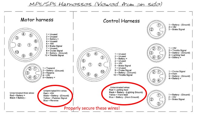

Thanks for the replies, it is a golden motor magic pie 5, the battery is putting out the correct voltage, I have also tested the battery plugged in to the holder (but not the motor) and that connection is fine too, the battery charge indicator next to the throttle is lit up so I guess that means it's ok.
I believe the controller is built-in next to the motor unit so possibly something has gone wrong there?.
The lit throttle LEDs do indeed indicate that full battery voltage is getting to the throttle. If the harness cables look absolutely pristine. (no scrapes, pulls, or pinches) I'd start with something simple like disconnecting both brake connectors just in case one got damaged. ( a jammed on switch would keep the motor from running...)
Another would be to check that the cable end terminations on the circled cables below are secure and intact.
Lastly for now with the battery connected, use the pin-out diagram and check for 5 vdc regulated controller power at the most convenient 5vdc location... (brake, PAS, throttle, ETC. )
