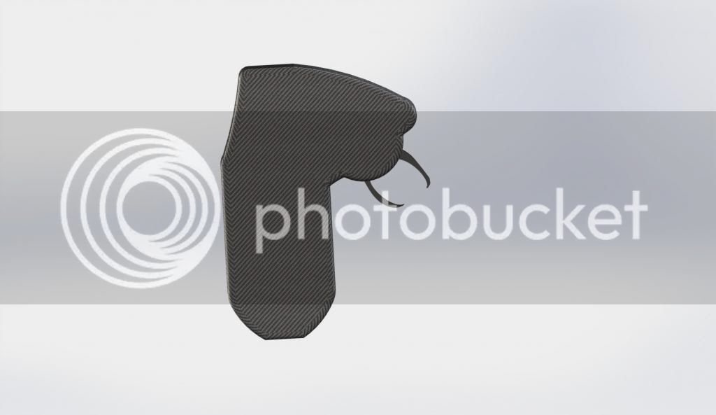

Nice artwork Richard.
Nice things about an Arduino/Bluetooth solution are:
  • small, light batteries, low battery drain
  • bi-directional communications for safety, etc.
  • easy ability to add as many 'channels' as you desire
  • programmability
  • very small size
  • connect to computer for setup via USB or Bluetooth
  • cheap
R/C transmitter has way more power and range than wanted or needed ... and other related problems.
I have the parts on the way for an Arduino/Bluetooth prototype. Everything but a decent trigger and enclosure.
Hope to have something to test in a couple weeks or so.
Source for a simple finger-cage trigger suitable for mounting on a standard 1/4-inch potentiometer shaft, and centering return spring would be most appreciated. Or a whole assembly including the pot.
Richard
