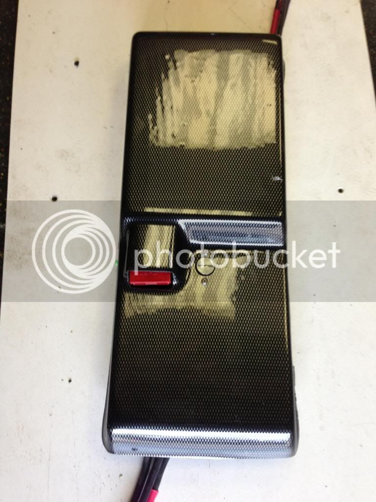

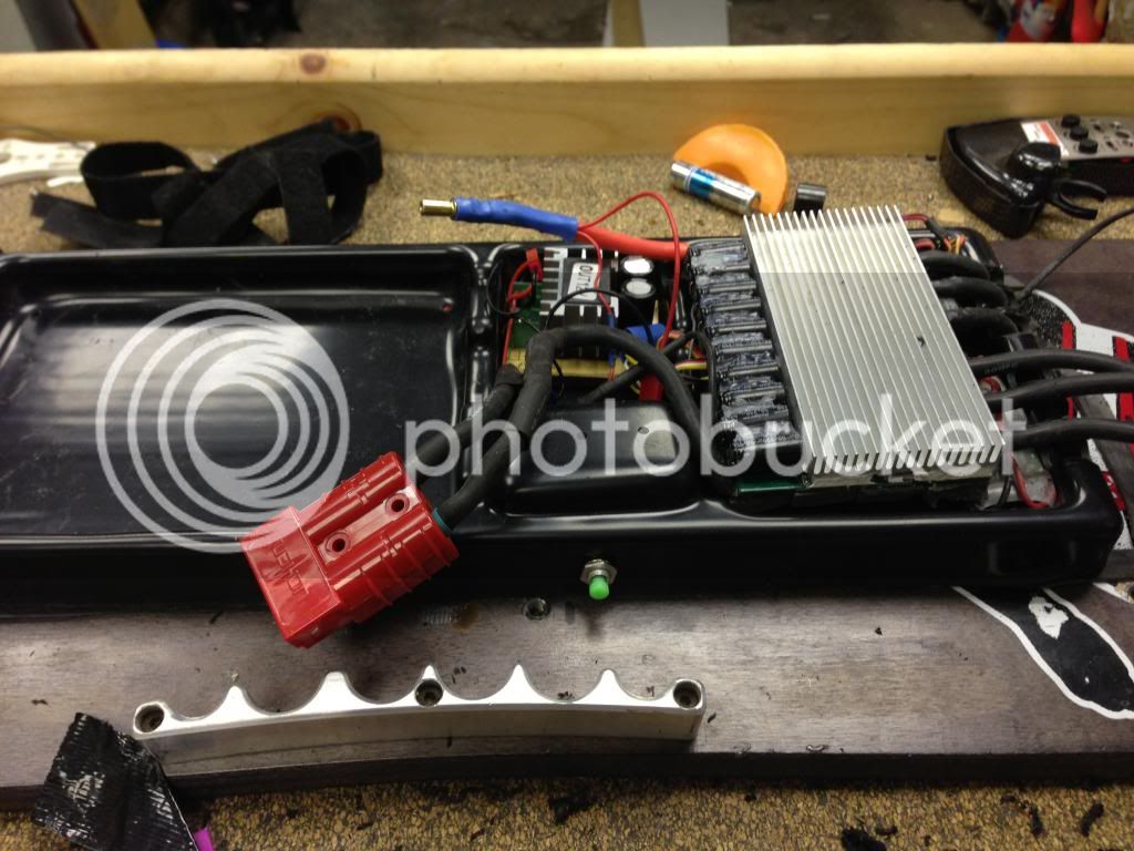

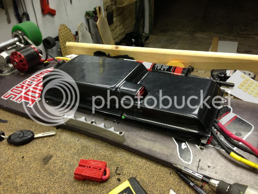

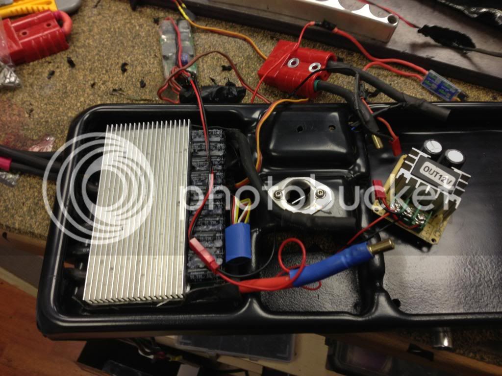

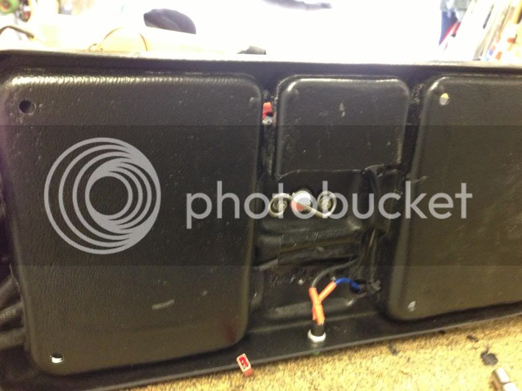

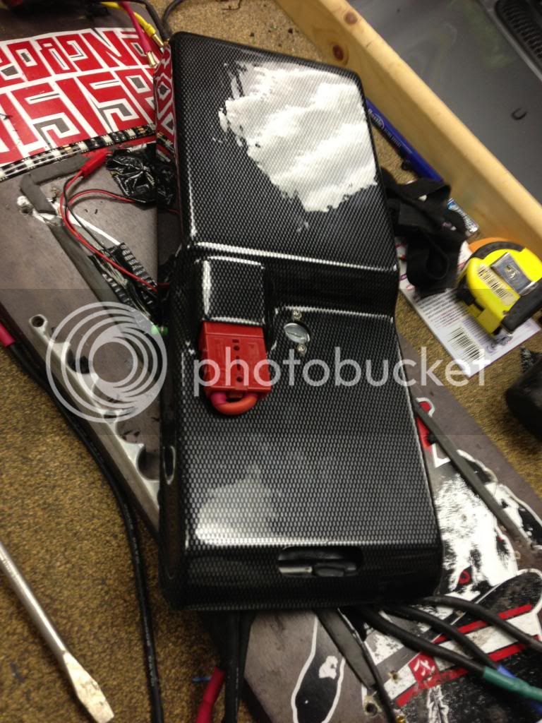

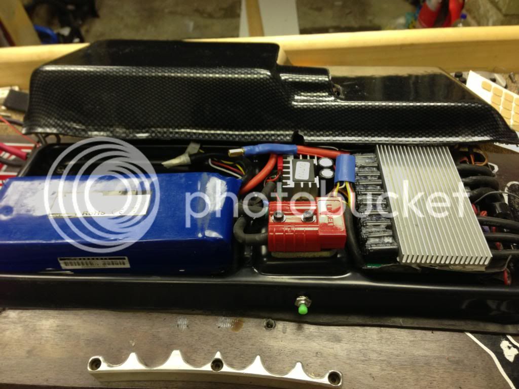

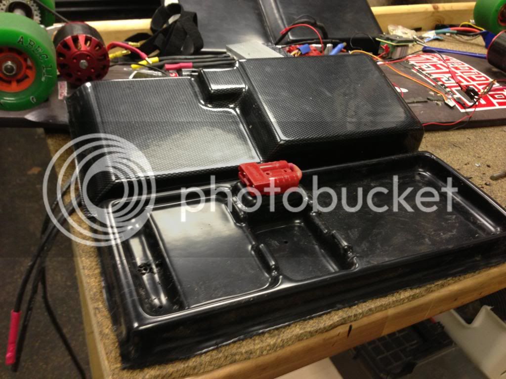

well I'd thought I'd just post what I've been up to for the past few weeks while i wait for my CNC shop to finish all the Caliber mounts ..Ive been resurrecting the Hyper EV with a new arming system and cover.. actually I have been riding my dual 50mm for the past few months I'm a bit scared at getting on the 'beast'!! lol
so here's a quick slide show of the makings of a new battery box and arming switch (using an Anderson plug)- and best of all the info I give is for free!! no $30 dollar fee here... :?
And as I'm sure you all know-if you guys need any help or info about building your DIY electric skateboard..don't be afraid to ask..were all here to help on the forum..
Test fit
V2 base
V3 base
Dzus clip added
