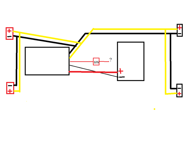

I'm working on a diagram for the accessories, lights, horn, audio etc.
This first diagram is basic as I understand the instructions below.
I'm a bit confused on the switch connection.
Won't I need to use a terminal block, to connect all the various accessories.
Something like this?
https://www.amazon.com/dp/B076BR7RSH/ref=sspa_dk_detail_3?pd_rd_i=B076BR7RSH&pd_rd_w=6M3vp&pf_rd_p=45a72588-80f7-4414-9851-786f6c16d42b&pd_rd_wg=Kh9EN&pf_rd_r=A9WXFDSAV3VDX08TFMX7&pd_rd_r=34fbb213-4b3d-43aa-b972-895098273161&spLa=ZW5jcnlwdGVkUXVhbGlmaWVyPUFXTFJQSzhGOFRKVkwmZW5jcnlwdGVkSWQ9QTA3ODczOTdKV1NPVE41MFk4MTMmZW5jcnlwdGVkQWRJZD1BMDc1MTk0NTI3OFFEUDhSVzc4TUYmd2lkZ2V0TmFtZT1zcF9kZXRhaWwmYWN0aW9uPWNsaWNrUmVkaXJlY3QmZG9Ob3RMb2dDbGljaz10cnVl&th=1
Should the thin red line (?) go between the terminal block, (positive) and the converter?
I plan on using a separate toggle switch, (for each of the accessories) in place of a key switch.
The diagram below only shows head and tail lights as an illustration.
EDIT UPDATE. Hard to read, but I wanted to stay with the wire colors, from the converter.
Need to wire so the 'key switch' from the controller sends power to all systems
And then there is this.

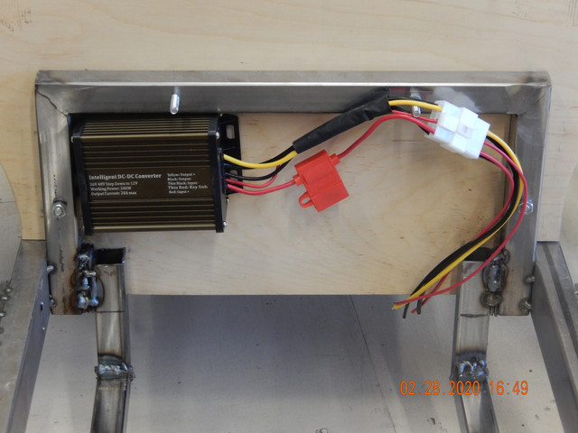

One thing to note: I assume this converter is NOT isolated, which means the main battery will be connected to one of the output wires. As a result, I recommend NOT using the vehicle frame for running power. Run pairs of wires to the lights, etc. and leave the frame isolated. This provides additional safety in the event a wire makes contact with the frame accidentally.

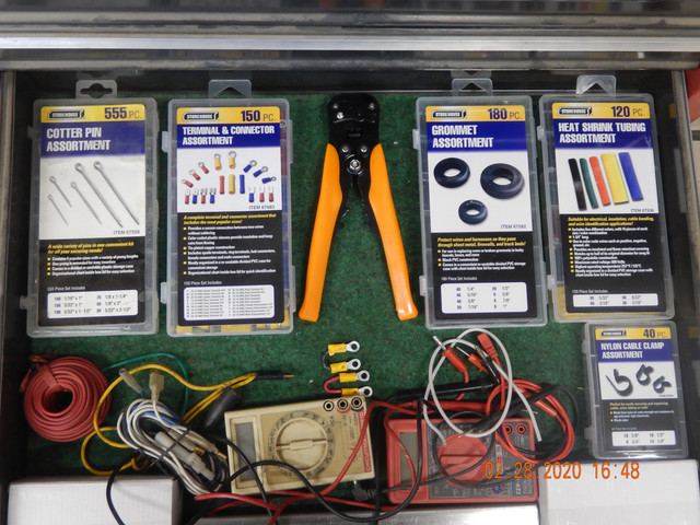

Had to replenish my stores of electrical bits and pieces.
Had a HF 30% off, so made a dash down there and stocked up.
Even bought a new crimper/stripper. My old one must be at least 40 years old.
Put to use some grommets and cable clamps. I like to keep as much tidy as can be.
Found out there is just enough room between the battery and the 'fire wall', for the converter and terminal blocks.

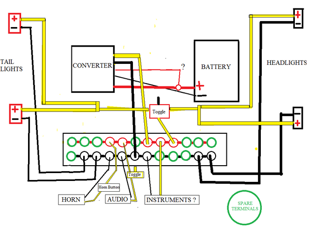

OK, still struggling with the schematic, but have been looking into
fuse blocks, relay's and dash switches.
It's been kind of cool and windy, of late, so little has been done.
I have been looking and learning, about what fuse blocks are out there, and relay's as well.
They look to be what is needed.

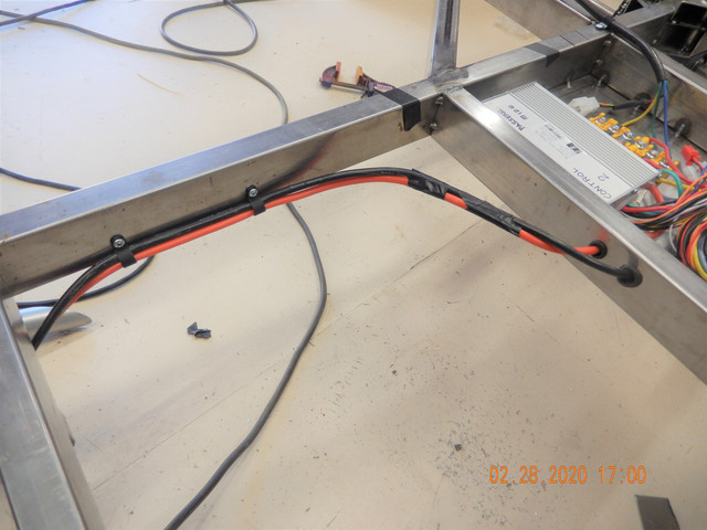

I got the wire, for the power leads from the controllers, to the converter.
Had to settle for #10 awg wire, which I'm sure will be quite satisfactory. It's only 3.5 feet long.

I've put in the hours, and worked my brain cells, to the max.
This is what I have come up with, just for the accessories.
Not all lights/accessories drawn in, for clarity.
Obviously I'm hoping that it is correct, but if not, more to learn.

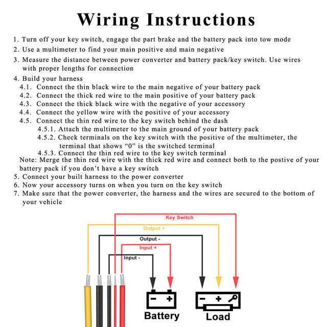

Something doesn't look quite right about the converter wiring diagram. In the text, it says to tie the small red wire to the fat red wire if you don't have a switch, but the diagram shows it going to the 12v output (I suspect this is wrong).
Use an ohmmeter and measure between the converter input and output wires. See if the negative wires are connected internally or if the positive wires are connected. This will clear things up. If the positive input and output are connected internally, then the diagram would make more sense. On mine, the negative wires were connected.
Since the converter has the small red "ignition" wire, you probably don't need a relay. The 12v loads can just come straight off the converter via the fuse block. There will be very little current on the small red wire so you can switch it with a small switch. The converter itself will act like a relay.
Also, I think the switch panel is made for 12v, so that should come off one of the fuses on the fuse block and not connect to the 48v battery.
You can use the big circuit breaker on the battery as the main power switch, but you might want a smaller on/off switch that's easy to reach. You could also use a key switch for this.
If I get time I can do a sample schematic for you.
Thanks fechter
I will do the testing as you asked, and get back to you.
I will work up another diagram 'without' the relay, and see if that helps clear anything up.
Fechter - tester results
Meter set on 2K
2 blacks --------------------connected (.000)
2 reds ----------------------not connected (no meter reading)
Yellow & Large black ----connected (+/- 375 )
Yellow & Small black ----connected (+/- 375 )
Meter set @ 2000K
Yellow & Red # 1 --------- one connected (+/- 294 @ 2000K)
Yellow & Red # 2---------- Not connected (@ 2000K)
I really am trying to get this on my own, but ?
FYI - I'm drawing this using Microsoft Paint, so you could copy it to your PC and modify it at will...I think.
Here is another look. I'm afraid my mind is in stalemate, or is it 'Stall Mate'?
I did notice that there are two sets of red/black wires coming from the back of the switch panel.
Also there is a 'key switch that comes with the motor kit.
Two for the Volt meter/USB/Socket (NC)
Two for the switches. (NO)
Have I created another 'direct short' by attaching the switch positive lead, to the fuse block positive terminal...????????
Yes, yours measures out like mine. Their diagram is wrong. Don't trust it.
Sorry it takes me long to draw stuff.
Basically, your main + and - from the battery branch out on terminal block and go straight to both controllers and the dc-dc converter input. The small red wires from both controllers and the dc-dc can all tie together and get switched to the B+ to turn everything on. This would be the main ignition switch, which could be a key or normal switch.
Everything 12v comes off the converter. Optional whether you want the switch panel to operate the 12v loads (seems like a good idea). Most of these 12v converters will have some sort of short circuit protection so the 12v fuses may be redundant but won't hurt.
You don't want any connection from the 48v stuff to the 12v stuff other than the ground.
