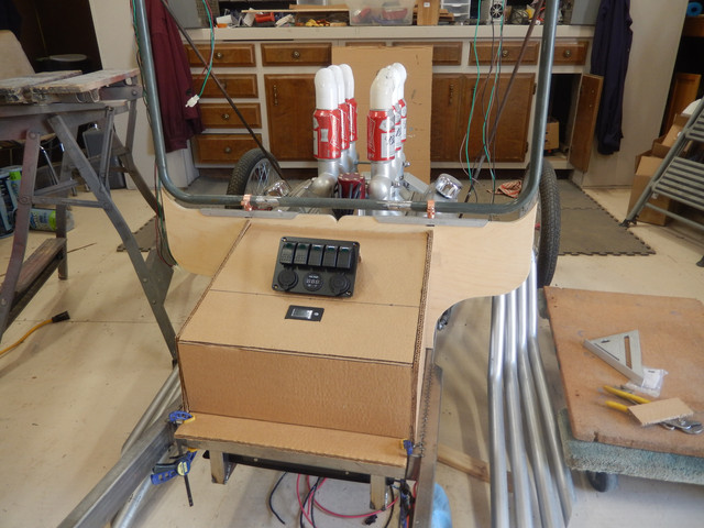

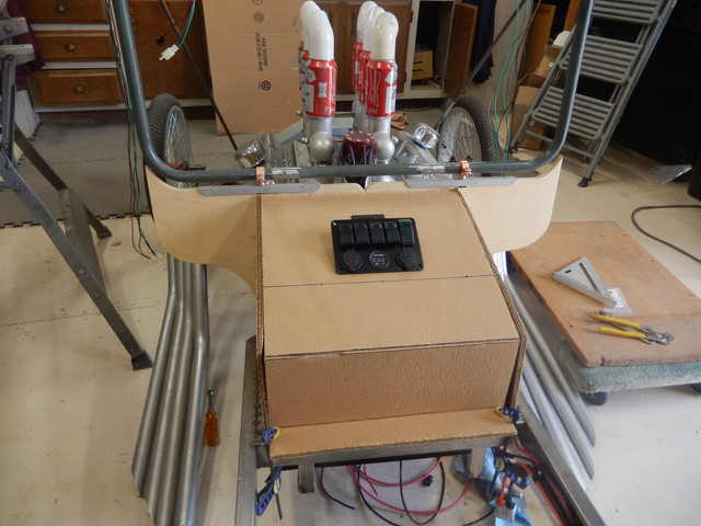

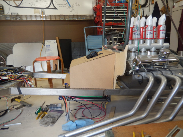

Today I've been working on a mock-up, battery cover/console.
Not what I had in mind, when originally designing, this car.
But the design has to evolve as the need arises.
This is but the first design and the most practical.
It's quite boxy, so it needs some contrasting pockets, holes, do-dads.....you get the idea.
I'm initially thinking of upholstering the sides with a contrasting tan fabric.
Or red sides, and wood grain in the center.
May even make it out of metal.
I will dwell on the design in hopes of fancying it up somewhat.
Three different heights.
There's not much room under the top, where it turns vertical.
Moved the voltage gauge to the front.
Looking good. I love CAD (cardboard aided design).

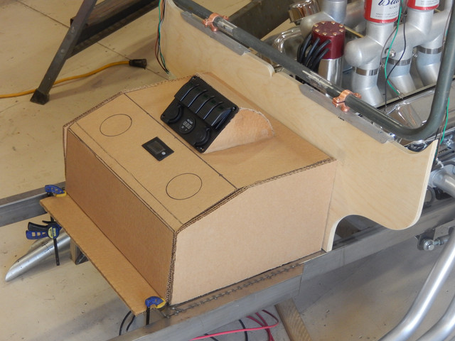

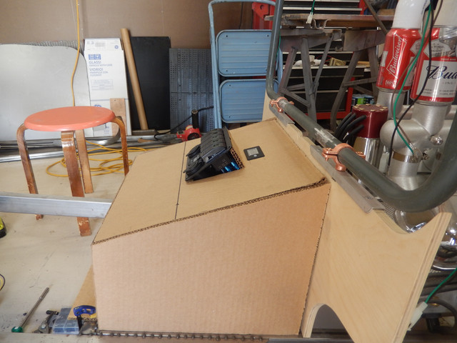

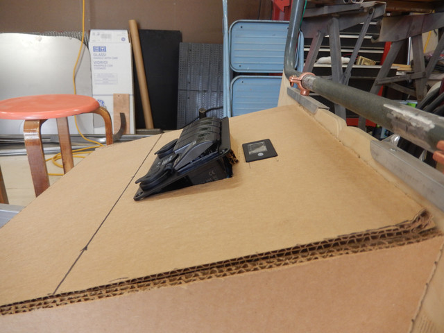

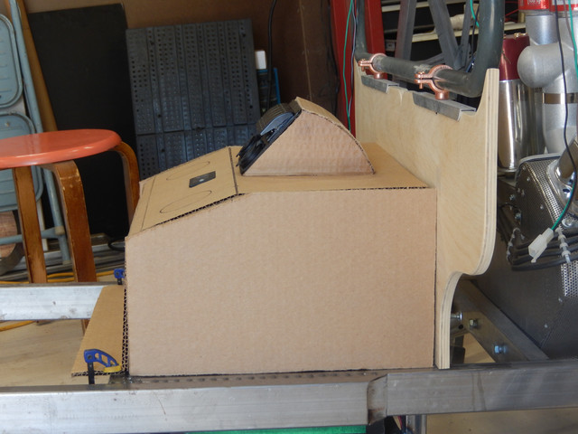

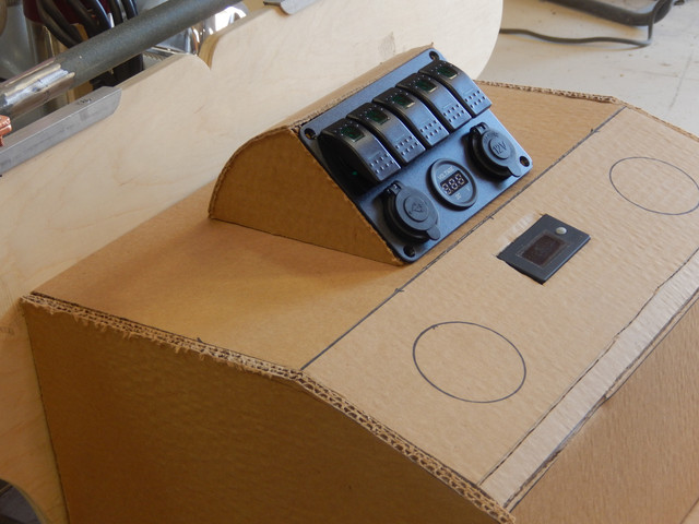

Another CAD mock-up. I'm liking this version a bit better.
But I'm waiting for the creative juices, to flow (wait, not 'flow'), to bring me other ideas.

I needed to see what the new console looked like with the body on.
Also how much legroom, remained with this design.
Also, worked on the visibility problem. Between my height and how the top is designed, I couldn't see straight out the front.
These pictures don't show the change, but with fiddling with the angle of the dangle, I settled on raising the front, two inches, which makes very little change in the overall appearance of the car. I lowered the seat height to its finished height +/-. It will also give me an attaching point for the required rearview mirror, and wiper motor. I wonder if I can get away with using a hand-operated wiper. I see a lot of them for sale. Maybe not legal for the street. I haven't checked yet.
The verdict is still out whether to use the 5-gang switch panel. I'm not sure what it is,
but my gut tells me it isn't right. Maybe something else should be used.
This type of 'hot rod' isn't made for creature comfort. But I'm not really uncomfortable,
though I'm seeing more of my knees than I would normally like. :lol:
Also, the time is near to think about installing the steering column/wheel.
Will probably use a removable steering wheel and/or a tilting column.
As you can see in the next two pictures, there's little room, in the motor compartment.
