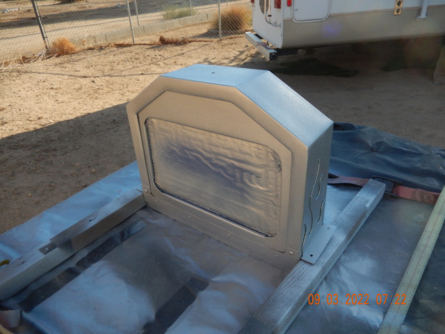

Adding a bit of color to this project.
I'm using Rustoleum silver 'textured' metallic for a base coat.
It is a very rough paint, which I have chosen to leave rough.
In the first trial, I sanded down (lightly) the silver and lost much of the brilliance.
After experimenting with the color coat and two-three coats of clear,
sanded with 400 grit and finally clear coat it again, it comes out smooth as glass.
Battery cover prepped waiting for color coat
The color coat with Duplicolor 'Metacast' from
https://www.jbtools.com/duplicolor-mc200-metalcast-red-anodized-11-oz-aerosol/
The price is fantastic @ +/- $6 per can less than local retail.
Bought 12 cans which got me free shipping.
I will be 'decanting' the cans and spraying the paint through my paint gun. (Better spray pattern/control)
This photo doesn't truly show the brilliance of the color or the metal flake sparkle.
This is with only four coats. I think I want it to be a bit darker, so will look to add one-two more heavy coats.
How sweet it is to see some color. Not without some setback and redo.
A mishap with the spray gun, ruined the first basecoat, requiring a complete repaint.
Then the spray gun spattered on the second go requiring another basecoat repaint. (My bad for not cleaning the gun well enough)
So this was sprayed directly from the can. 5 coats to get it all to match.
Next step after a few days of letting the color coat cure will be 3-4 coats of crystal clear enamel.
I practiced on another small piece and clear coated it.
This looks great but the clear coat makes it burst with color and sparkle.
I used Rustoleum Silver 'textured' to achieve the metallic look I wanted.
It takes 4-5 coats of clear to achieve a smooth finish.
Enlarge the photo and you can see the sparkle.
Needs some silver touch-up from tape bleed, but overall it looks great.
