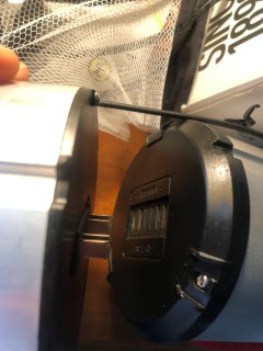

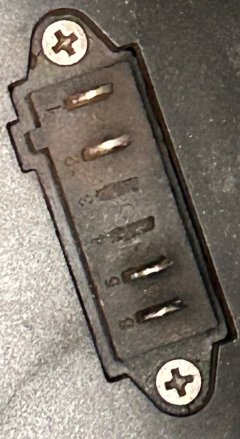

My bike's been losing power over bumps. All connections have been checked repeatedly. I just discovered my battery's female port is being chewed up by the male base. Can this be the culprit and is it fixable?
Very likely the cause of your problem. Another problem is that you probably cannot get the parts to replace from the vendor.
I would personally solder on some connectors to the battery and base that run externally, basically bypassing this connection.
This is just poor design with no interest in longveity, the best bet is to fix the design
We used to call these fork-and-blade connectors.
They can work well when correctly designed, fabricated, and with good materials. Cheap knockoffs, not so much.
Depending on the access, sometimes you can improve the connection by squeezing the "forks" so they can clamp the blades more securely.
That yours appear to be losing connectivity over bumps makes me think the battery is loose in the base. Maybe you can clamp them together better with straps?

I considered that but it's as tight as new. So I might be able to replace the fork? I did notice that the blades are rather rough, not smooth, and seem destined to destroy the forks. What materials should I look for in a fork or fork-and-blade set and where might I find them/who uses them outside of bikes? Searches don't turn up matches that resemble bike battery connections. Is this one side of a fork?Screen Shot 2026-05-05 at 2.48.25 PM.png
As they are usually molded into place, they are not really DIY replaceable. That is why neptronix suggested running the wiring outboard of the original connector and splicing in more robust connector. You would trade your snap-in/plugged-in convenience for a better connection.
The blades are rough and eroded from several disconnections/connections while under load, possibly exacerbated from poor alignment, poor materials, poor spring tension, or incorrect sizing.
My idea was more of using a small flatblade screwdriver to retension the fork contacts so they grab the blades more tightly. Might not be enough access to do this.
Replacing the blade connector will not fix the problem except temporarily. To me it seems your battery can move enough when bumped that the terminals lose contact and spark. If you replace with the same connector you will get the same problem.
Neptronix is correct that the best fix is to bypass the original connectors and attach better ones on both sides. If you say what volts and amps you are working with we can make recommendations.

This is the base
It slides up into the tubular frame
and the battery is dropped in from above.

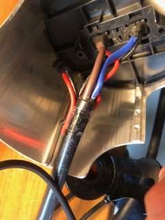

Oh you're lucky, you only have two wires. And you also have lots of spare wire.
You need a drill, some grommets ( auto parts store may have them? ), a soldering iron, two antispark 90amp connectors and the will to go through with the procedure. But in this case it isn't going to require rocket science. :)

I grasp the connecting but can't see how I'd be able to unplug it as the base is not accessible once in the tube. I'd need to fish it through the bottom which is stuffed with controller and wires then cap it with screws each time I take it out which is like doing maintenance twice a day. Is there a way to align plugs or upgrade the fork-and-plug so that the battery can drop in? Otherwise it seems this solution might only work if I put my internals outside the frame so as to access them, which I'd rather not as this is my all weather off roader.
Welcome to the hidden cost of a bike with a proprietary frame and components :O
I would run the wires for the battery connection outside of the frame and battery holder. The holes that the wires go out of should oriented downwards so that water doesn't drip into it. use grommets for extra protection against the elements.

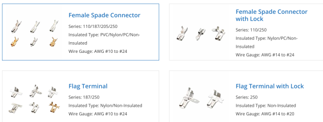

I'm also not finding this configuration with 4-pin with two empty slots between. Can I use any config of 4 pins or the bottom example as (i think) @99t4 used? Is 45A 4-pin Power Discharge Connector all I need to know to buy or do pin numbers not apply to some? Can I just remove two or only connect four? (ali examples)
If you are replacing both sides then there's no reason you couldn't double up the pins ( negative + negative, positive + positive ) exactly like your existing system. That would be ideal to minimize resistance in the connector
