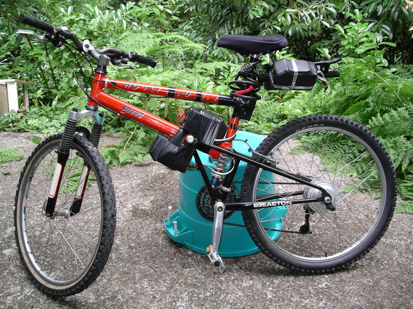

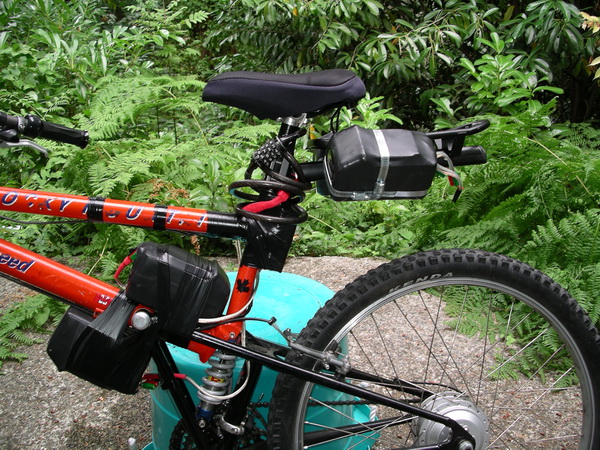

Okay - here's why I went to extra lengths to waterproof the batteries with shrink tube.
They're the same size as before, but now waterproof, so they fit compactly onto the bike.
In these pictures, I have two attached 2x20V=40V to a slide on seat post rack. With the Keywin 36V
Infineon controller, that's all you need. Although 3x20V=60V goes a lot faster, it weighs more too.
You can see the controller taped onto the back of the tri-frame, just under the rack.
Ignore the other batteries taped to the inside of the tri-frame. I was just testing this as an even
lighter possibility, since you would not need the rack, which is about 1kg.
I prefer just using the 2 battery rack, because its lean and clean, and allows you to slip the
rack off the bike to charge them in the house.
