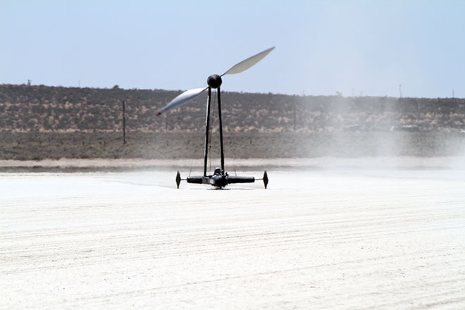

It was because the claim is that, from 1.0 to 2.5, the kar is being accelerated by the krazy kar sucking energy out of the road with its wheel. Then said energy is chained up to the prop . Then said prop turns and throws air back much like a Piper Cub or a Corsair and so makes thrust. Said thrust supposedly accelerates kar by Newton action and reaction. The munchkin klan claim has been that yo kar is powered NOT by being blown by the wind from 1.0 to 2.5. Therefore, by the said claim, yo kar is exempted from tacking silliness.
Now you once again switch stories and say the yo kar is really tacking from 1.0 t0 2.5.
We have been here before. I complained that you silly little devils changed your tune from one manner of propulsion to another whenever it suited you to avoid admitting that your story failed to make good sense. Now you are doing it again.
Seemingly you all are prepared to continue playing your truly silly juvenile game as long as you can find a fool to provide you with an ongoing argument. I have been patient, presuming that you all were honest people who needed some science education, and I have charitably, in good faith, tried to help you. You all have bent over backward to be devils who deserve no good thing.
Yo kar is a piece of halucination that violates every basic tenet of Newtonian physics. It is either a very silly mistake or is a criminal fraud.
Yo kar, if it were somehow true, without an explained basis in known physics, or, in Yo New Physics, which you all have not been bothering to write and publish, is is completely useless and worthless. I have pondered this and, if it performed as claimed, it could not be engineered into any device that could be useful.
It is worthless whether it works or whether it does not work.

Mark Drela said:
This confirms that the DDWFTTW condition V/W > 1 is achievable with a wheeled vehicle without too much difficulty.
Here some more comments:
http://makezine.com/2010/11/05/what-ive-learned-about-wind-carts/
Mark Drela said:
Although DDWFTTW seems like it violates physics, it really does not. The various analyses show this, and the cart experiments on YouTube are definitive proof. In my view, the most closely controlled and unambiguous DDWFTTW demo is the cart climbing up the tilted treadmill. The main problem is then convincing some people that this is equivalent to DDWFFTW. But whoever tries to argue against that equivalence is really arguing against Galilean relativity, which is unassailable. So that secondary argument is a complete waste of time.

Explain to me, in your own words, how yo kar avoids a terminal velocity between 0.0 and 1.0, and then maybe you can be believed.
Terminal velocity of a powered propellor driven vehicle is when the thrust from the propellor equals the drag forces.
So the DDWFTTW vehicle has a prop shaft linked by gears and chain to the wheels.
V_wheel x Ratio = Propellor_Tangential_Velocity
Propellor_Tangential_Velocity is defined as the velocity at some point on the prop that the sum of the aero forces on the prop blades can be shown as force at a radius from the axis.
As shown in the diagrams above with velocity and force vectors an imported dotted red line is shown. It is labled as the "helical path" which the blade is constrained to.
Describing how the helical path is similar to a wing nut moving on a stationary threaded shaft is related to the pitch angle of the thread will help in comprehending that the path of say the tip od a prop blade can be drawn in two dimensions. The angle between the forward motion (in line or parallel to the prop axis) and the helical path is "constrained" at any vehicle velocity as long a) the wheels maintain traction, to an angle detirmend by the gearing ratio.
NOTE the propellor spins at a rate proportional to the wheel velocity !!!
When the wheel velocity at the axle is the 1/2 the tail wind the prop will be at known revolution rate. The propellor has a Thrust vs RPM vs Air Velocity charateristic that can be measured or accurately computer modelled.
So can it be comprehended that at 1/2 tail wind speed the vehicle can be accelerating faster than if the chain was removed.
With no chain the prop would free spin in opposite direction and experience some forward thrust due to the areo drag from the tail wind also like the rest of the vehicle frame and wheels.
BUT what happens when the chain is attached?
The prop is driven by the "WHEEL AXLE" not just the "Wheel".
Torque is transfered from wheel axle to chain tension to propellor axle torque to a blade radius reference point travelling along a helical path that a vector sumation can be calculated to descibe the the propellor blade aero forces due to its motion through the air mass at vector velocity that can be described by the sumation of the wind velocity and blade tangential velocity along the constrained helical path.

This is typical areoplane dynamics. If your stuck on this then you can't understand how any prop driven vehicle.works.
So what detirmins the Wheel Axle Torque?
The wheel is "gripping" the stationary road surface, no slip.
The dynamics on the propellor blades are creating a thrust forward for the considered operating point of 1/2 tail wind.
This thrust force is pushing through the axle "thrust" bearings ;)
The ridgid frame transfers these to wheel axle bearings.
The forward force at axle is applied as a torque arm (think levers and childrens see-saws and fulcrums) over the wheel radius to the "gripping" road.
At the road contact patch area a force is returned to the wheel according to momentum physics.
The earth supporting the road has a huge radial moment of enertia due to it mass density function .
Two rear wheels on the axle to share the grip and two blades to make the thrust.
acceleration is from Force / Mass ratio.
Power is Force x Velocity
Work energy is Force x Displacement
These are Vector calculations The result is based on the effective or apparent Force in line with the Velocity or Displacement vectors.
So the prop spins because it is driven by torque from the wheels that a pushed (or driven) by thrust from the prop.
Now this sounds circular problem but in fact it "ORTHAGONAL".
The torque on the prop is "ORTHAGONAL" to the resulting thrust.
The moving Air mass relative to the ground (some call it wind) has kinetic energy relative to.the ground reference frame.
The "tacking angle" of the aerofoil propellor "blades" is caused by the gearing ratio constraining the blade pitch velocity as a ratio between the vehicle velocity and the tangential blade velocity.
So energy is split into.flows through the chain (verticle) and the rigid frame horizontally forward.
