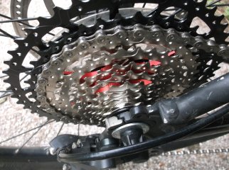

I currently use the stock chainring on my tsdz8 and there is not room to move it even a mm further inwards because of the frame.
I have a 7 speed cassette and my chain is currently centered right in between the gears 5 and 6. This makes the gears 1 and 2 unusable and my 3rd gear sometimes falls off. I saw that some people modified their 9 speed cassettes (subrace csm980) and removed a few cogs. I would lile to remove the cogs for gear 2, 4 and 6 which would leave with 1, 3, 5 and 7 which is enough for an ebike. Is something like that possible on a 7 speed.
I am also getting wheels which are hg 9 speed and up compatible so if nothing else works I could switch to a 9 speed.

I am uh..using an adapter for regular chainrings and spacers with long bolts to move the chainring in 5mm or so and a 10 speed cassette. If you have an 11-12 spd hub, you could just put a spacer behind the whole cluster to move it out with a 10-spd cluster.
This setup I'm using will go to 38:41, but the chainline there is pretty bad, so I have it locked out to 38:38.

I'm Using a Sunrace 11-52T cluster on the rear.
It makes it to the 2nd biggest, but that's kinda fonky, so I lock it (the derailleur) out to the 38T before that sprocket.

After going to my local bikeshop i got a really good deal on a new rear wheel so i decided to try some things before going all out on the high end stuff
Well after getting the new rear wheel i decided to try out the decathlon 9speed shifter, rear derraileur and cassete. And i am very surprised by how well it works. I also took a new 9 speed kmc chain and a cncd aluminium front chainring and i can use all my gears without issues now. Even tho the new front chainring move the chain another cm out and makes the chainline even worse it yields better results.
I feel like one of the big contributors is the rear derrailleur that although it doesn't have a clutch has really high tension. It's stronger than a shadow derrailleur with the clutch off but a tad bit weaker compared to the clutch on. All in all it was a really good upgrade from the previous setup.
The cost also wasn't too high:
Rear Wheel: 60€
New tube: 8€
New Schwalbe Johnny Watts 27,5x2,35: 25€ (also from the local bike shop)
New Casette: 18€
New shifter: 16€
New rear derrailleur: 25€
new chain: 14€
front chain ring: 24€
total: 190€
