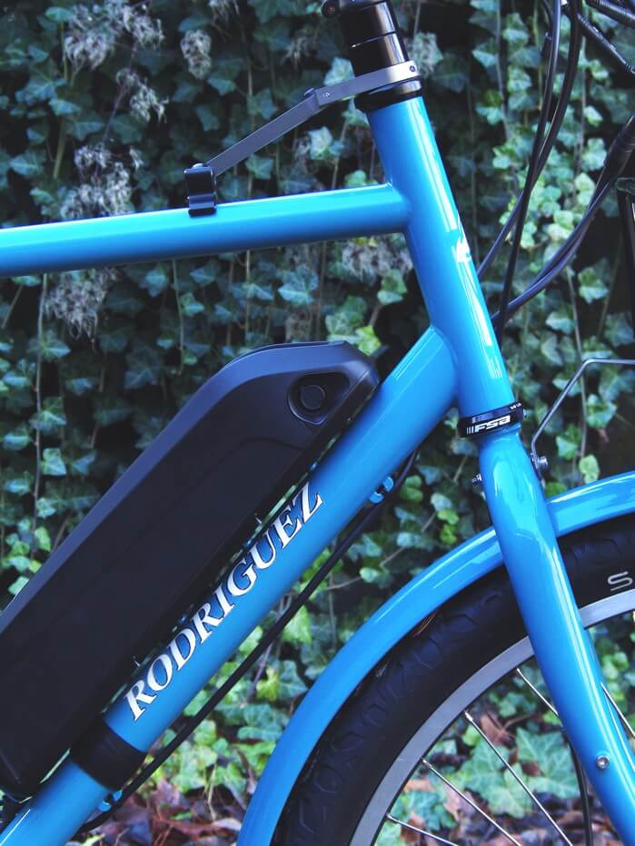

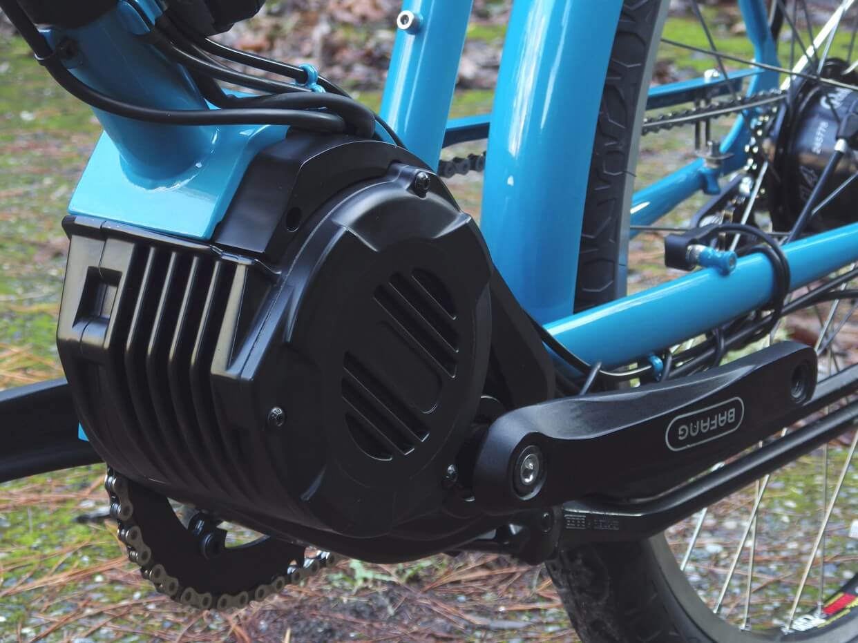

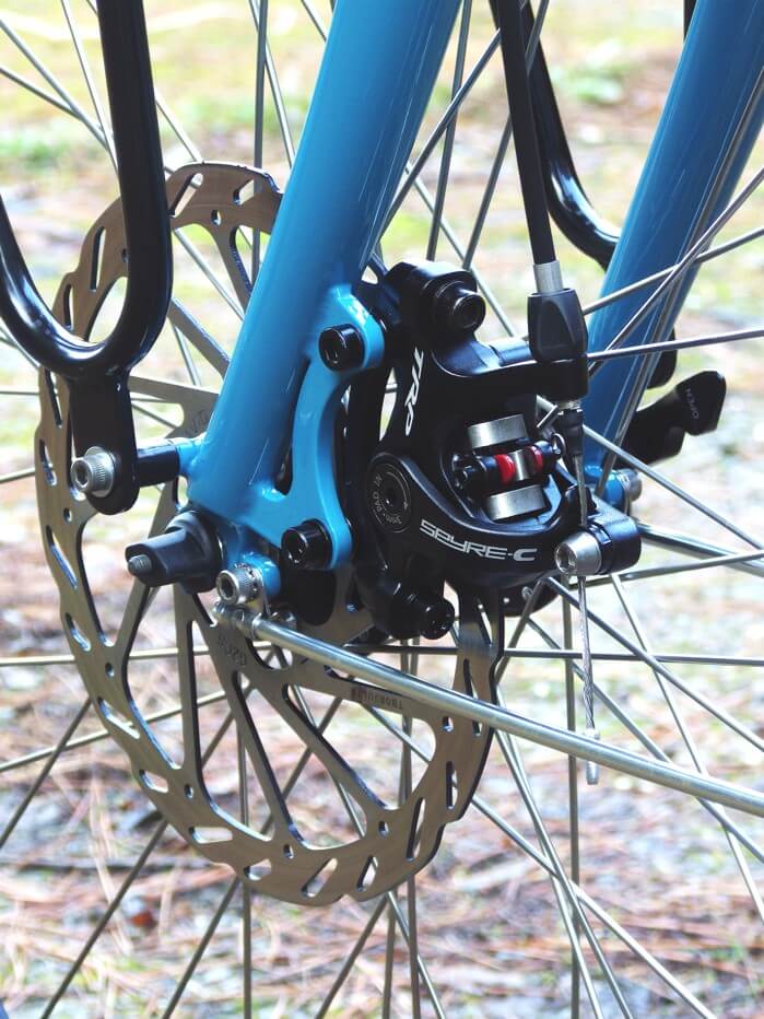

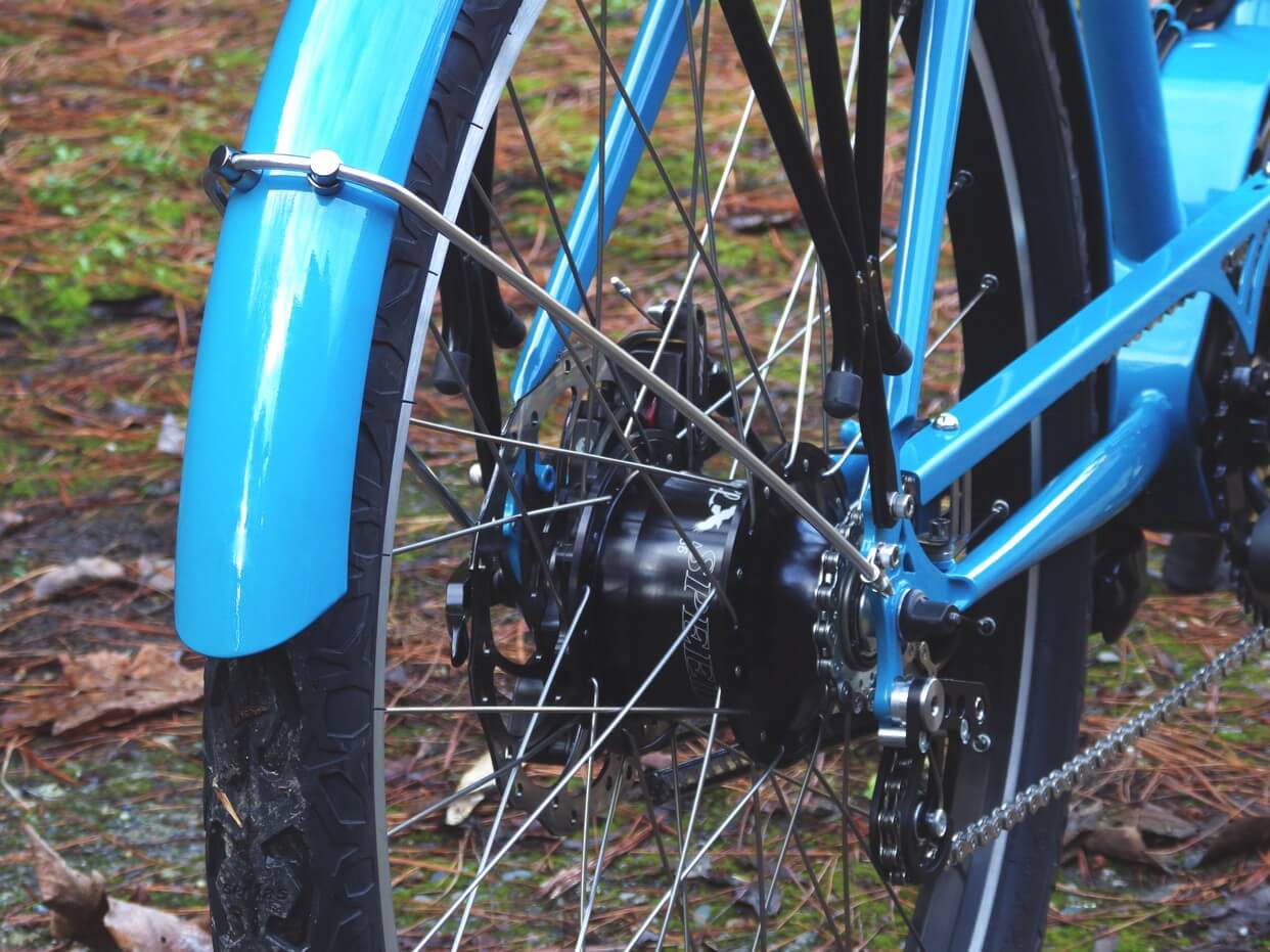

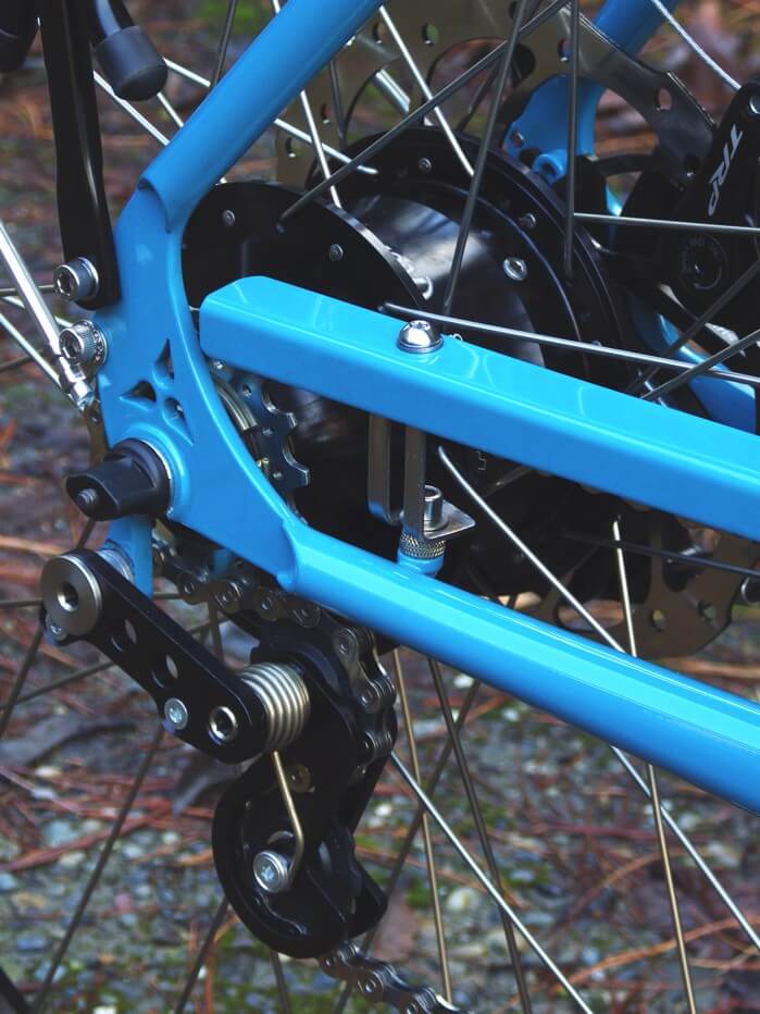

I'm 6'6", 270 lbs with a 34" inseam. Nothing really ever fits me so having something custom fit for me is just par for the course.

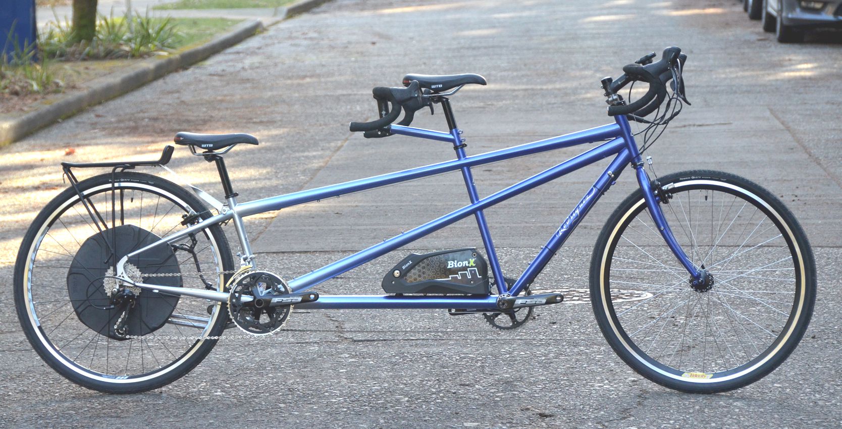

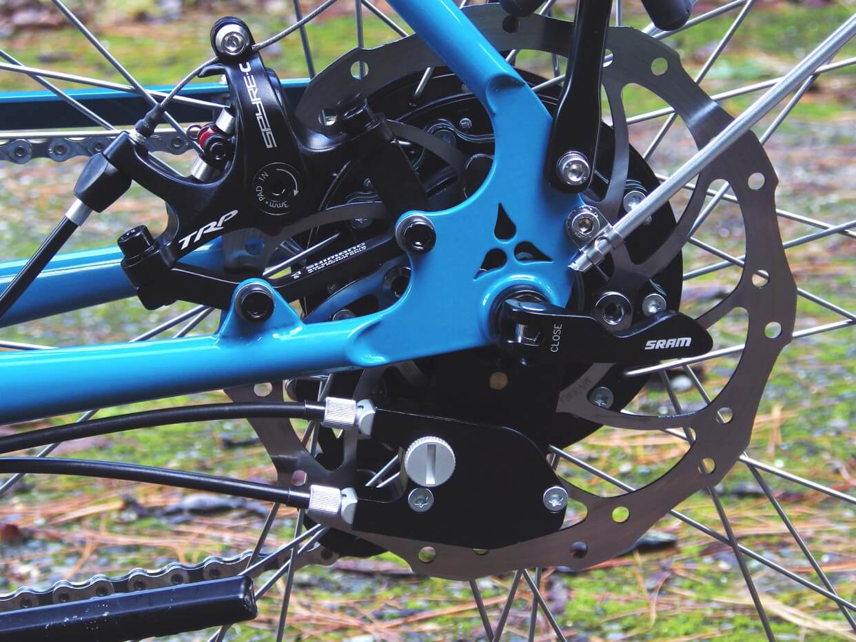

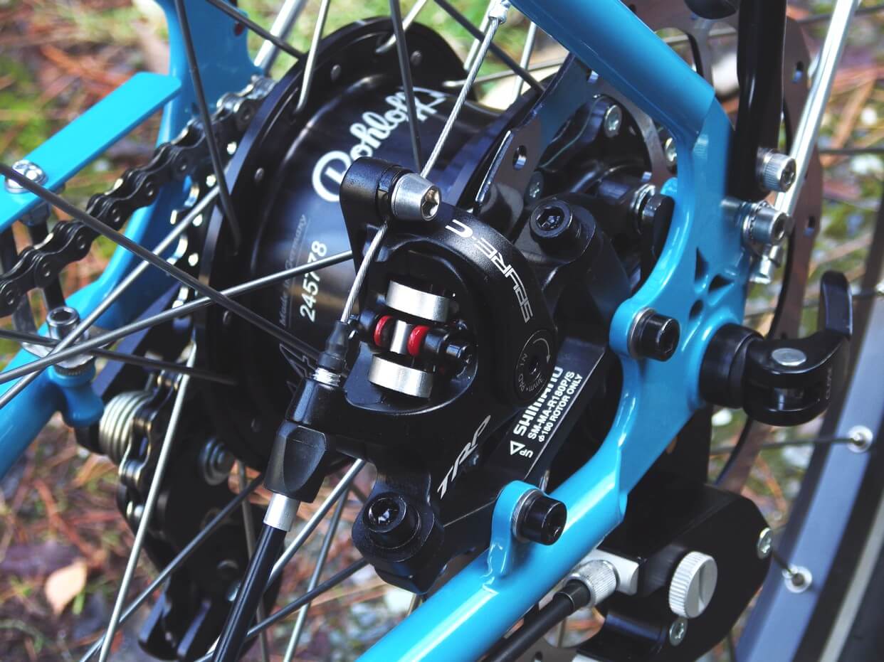

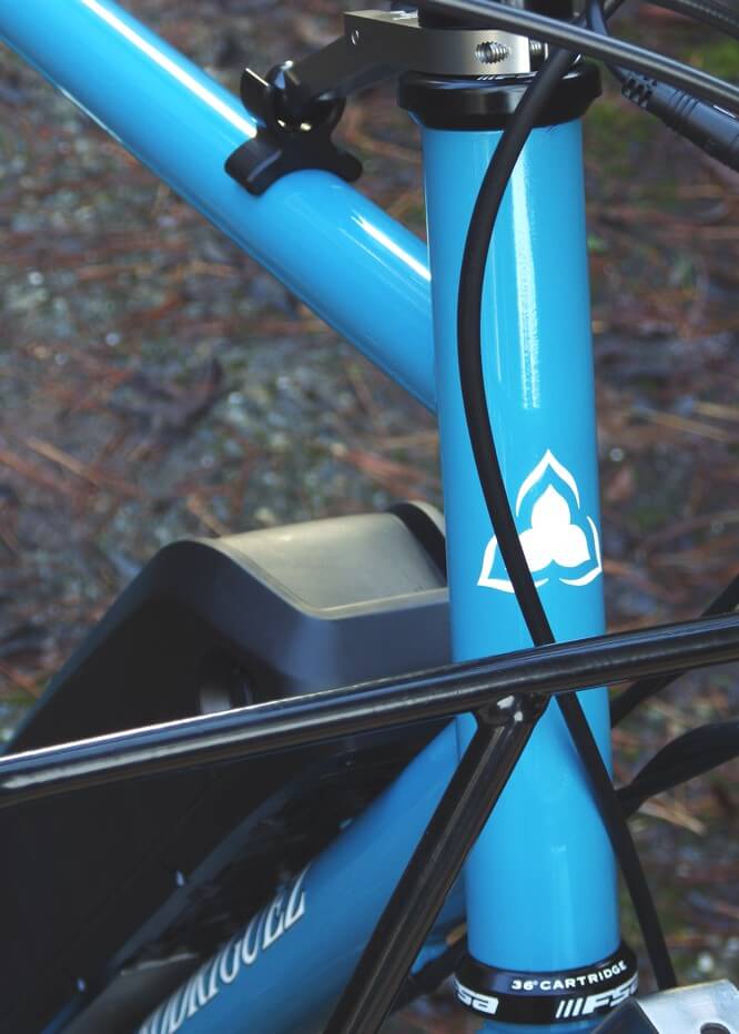

Here are some examples from Rodriguez bikes.

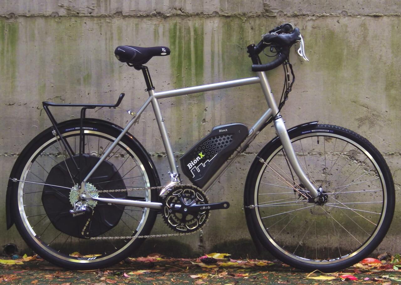

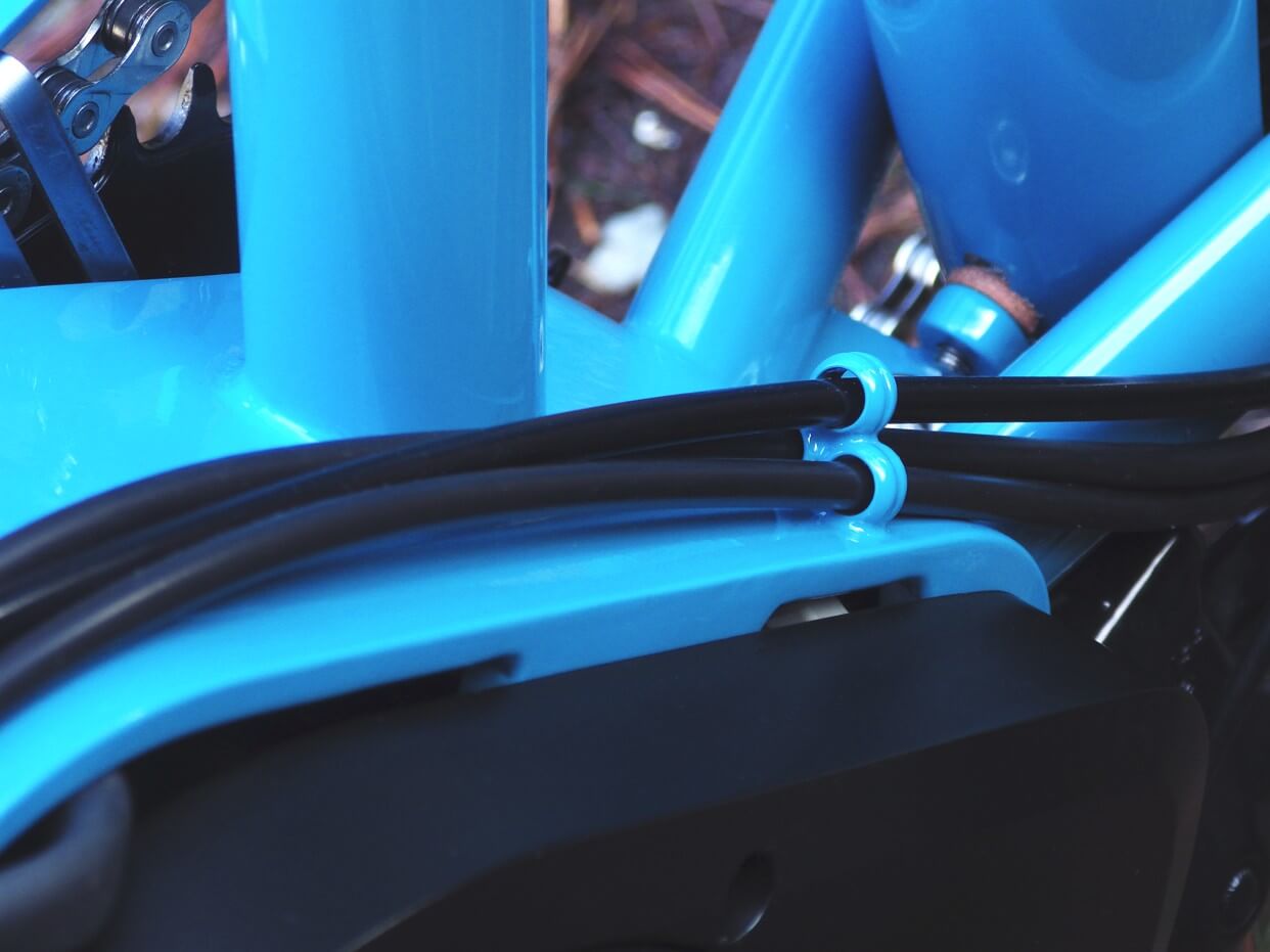

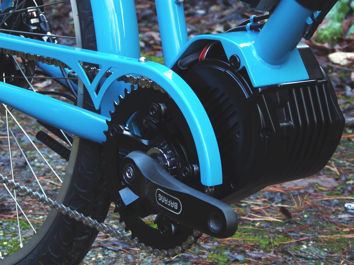

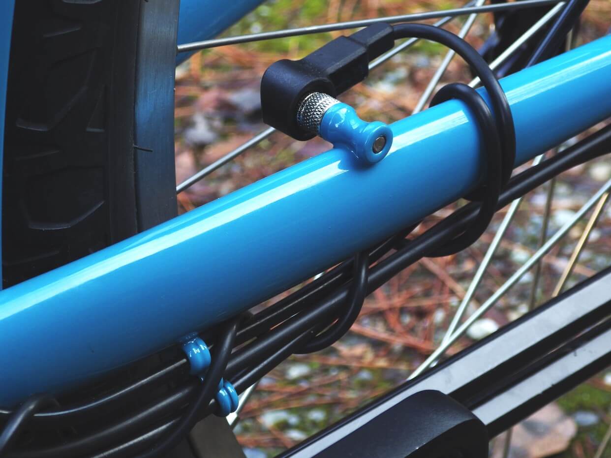

I hear you. I'm 6'8" and about 350 lbs. I have only ever had one tailor-made frame, by David Bohm of Tucson. Here are a couple of older photos showing its original configuration with 26" wheels:
It is fitted with 29x2.5" wheels and tires now.
Mostly I've gotten by with retrofitting 68cm frames and other large bikes with sturdier cranks and bigger cockpit parts. My current e-bike is one I built myself from the rear triangle of a 68cm road bike plus some chromoly tubing:
IMG_20171215_162436.jpg.
There are a handful of commercial frames that would be big enough for you, like the XXL Surly offerings. They aren't as nice as a Rodriguez. But nicer than a scrappy homebuild, most likely.
