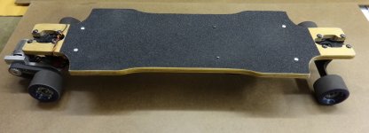

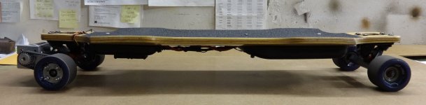

I have kept putting this off for some time but I finally have the time to put this up. Here everything I have put into this board plus some pics of the build. This is an ever evolving project with a lot of trial and error so I have made quite a few mistakes since I originally started, like destroying ESCs or redesigning motor brackets. I have found that with this project back up parts are necessary, especially when it comes to making your own bracket.
• Helmet.... if you choose to embark upon this challenging but rewarding journey the very first purchase you make is for a helmet. I don’t care if you have the money to buy everything at once, put the damn helmet in your shopping cart first. Oh, what’s that? You say you don’t plan on going faster than ‘X’ mph?... Get a helmet anyway
• Churchill MFG – Suzie Slide Through
• Metrowheels – Metro Express
• Caliber – 50° 10”
• IDS Oust – MOC 5
• 1/4th risers
• 200A Turnigy ESC
• (3x) 2s 6Ah 25c NanoTech LiPo
• 213kv SK3 Motor, also been playing around with the SK3 192kv and the SK3 245kv
• HK-GT2B Rx and Tx
• 8awg wire, XT150 connectors, 5.5 polymax connectors
• Hair clipper kit, shaving trimmer kit (these two are not a joke I swear lol, they were lying around the house I used the plastic cases they both came in)
• Turnigy Mega 400W v2 charger
• HobbyKing 540W Power Supply
The motor bracket is made by me in my garage with easy to use tool (Safety is still priority!!!):
• Stationary Workbench Drill Press
• Drill gun
• Hacksaw
• Large assortment of metal files
• A lot of different sandpaper grits
• Dremel
• Vice
• Tapping Set for Metal
• Aluminum Flat Bar (7” x 3” x ½”)
• Socket set screws ¼-20 x 1”, ¼-20 x ½” and ¼-20 x ¼”
• There is more I just cannot remember, I will add later what I cannot recall now.

Awesome build, truly homemade! I'm guilty for not wearing a helmet though it's just too cumbersome carrying one around. I haven't wore one for the last 500-600 miles of riding.
How are those XT150 connectors? Do you think they're really needed? Your enclosures actually fit real well. You should get one of those black wire sheaths to cover the wires in the middle.
I definetly like how you drilled the aluminum pulley onto the wheel. It's definetly the way to go as it's a lot more stable and solid. I'm going to try some 76mm wheels and drill through them should be nice.
Wow that mount is pretty sick for handmade dude! Awesome sand down. Nothing is usually made that way anymore I assume since most things are CNC'ed.
Question - When you threaded your holes did you thread them by hand?
I've also added your thread post into my guide below as it should help people for a true DIY build.
That motor bracket is no joke. :lol:
For awhile I was running around with 12awg wire and XT 90 connectors, twice I had a large enough arch/spark-jump to literally melt the connectors together. The blame for that is probably on something I did but nonetheless I decided to upgrade to 8awg wire and the XT150, I'm quite happy with the decision too because the XT150 connectors are a lot easier to work with than small connectors.
Tapping the holes is done by hand its not as hard as it look, a simple tap and die set can be bought at home depot but I you got the funds I would recommend buying tungsten carbide tap and die set because I actually broke off a cheap home depot tap inside one of brackets :evil: its a pain in the ass
Well done. I like how you took pics of the entire manufacturing process. I recommend you add two low-ESR capacitors to the power inputs, in-between the battery and controller (the stock ESC already has caps, but you will need to add more to suppress voltage spikes, because you weigh a lot more than a model airplane). Only $2 each.

Its funny that you mentioned that because my order from digi-key literally just came in :mrgreen: they were out of the 35 volt 1000microF, and out of all the larger ZLH series this had the largest ripple current rating.
These are but a fraction of the pictures taken, I will add the rest soon plus the pictures of mistakes and other bracket designs.
The ESC is the 1/5th trackstar 200A for cars, I just took everything and fitted the circuit board inside the smaller case
