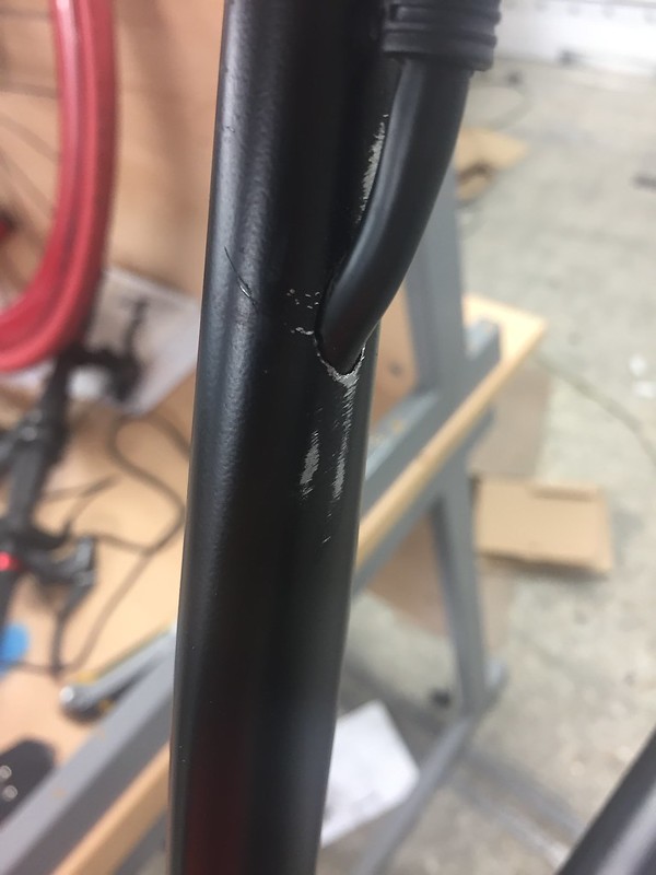

Frame Modifications
Because I hadn't taken chunks out of my frame for a few days I got the die grinder out again to work out the cable routes though the bottom bracket. This is how the frame started, I've noticed in all the tube welds there is a relief hole, i'm assuming this is for air flow during welding, or to purge the inside with flux.
2 minutes later with a carbide bit...
This cut is pretty rough but it was so difficult to keep the bit from biting and it will be hidden, I just need to smooth it out so wires don't snag.
I want to try and get the motor cable to run mostly internally as well (inspired by seeing the hole in the photo above that goes to the rear drop arm).

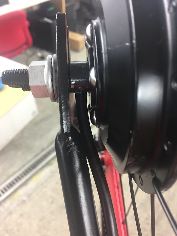

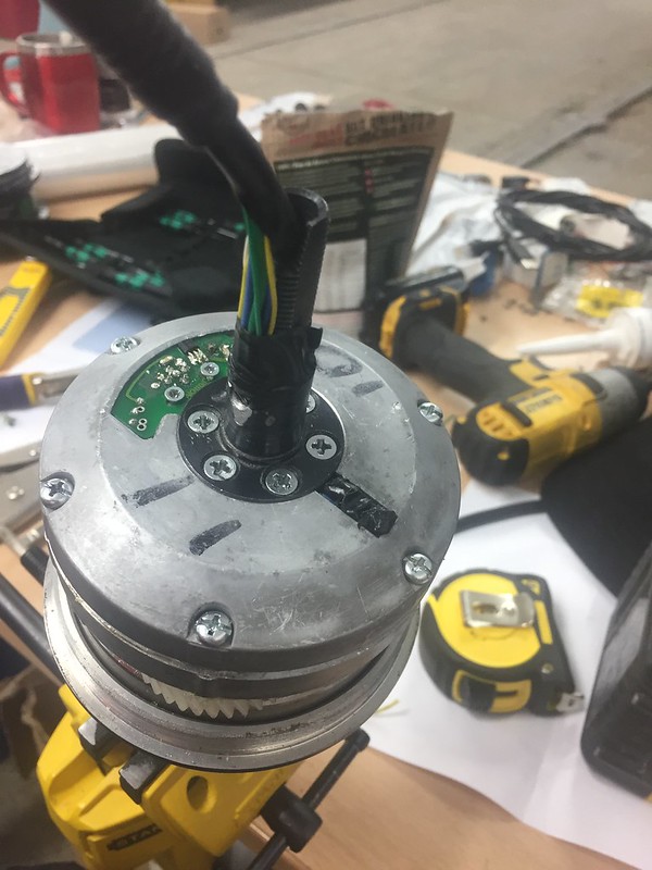

Motor Modifications
I never liked how the motor wire protrudes so much from the end of the axel. I've drilled a hole in the axel on the inside of the drop out, probably best I just post the photos.
Using the vice on the flat section of the axel to let me file the shaft and get a flat surface on the same plane as the top of the vice, making it parallel to the tangent.
A bit of fiddling with a drill, file and die grinder later..
Wires in the motor at a good point to cut and splice together once shortered and I'm 100% sure the lengths are all right.
a bit of black on the filing marks and hopefully it will be completely hidden.
Rough positioning of the 'Juliet' connector. Fixing method to be determined, probably make a brake line style crescent profile slot to braze on.
Agreed. That is one reason I am running a Bafang hub motor rather than a Cute. That side of the hub is fixed to the axle. Why did you not simply bring the cable out a hole in the side of the hub?
Edit: never mind that question. I see that there is a cover that goes over it :(

@Motomech Ah, I just saw the bafang motors that do that. The shaft that I have drilled is the only external non rotating part. If you see the photos the next part has the screws for the brake rotor on.

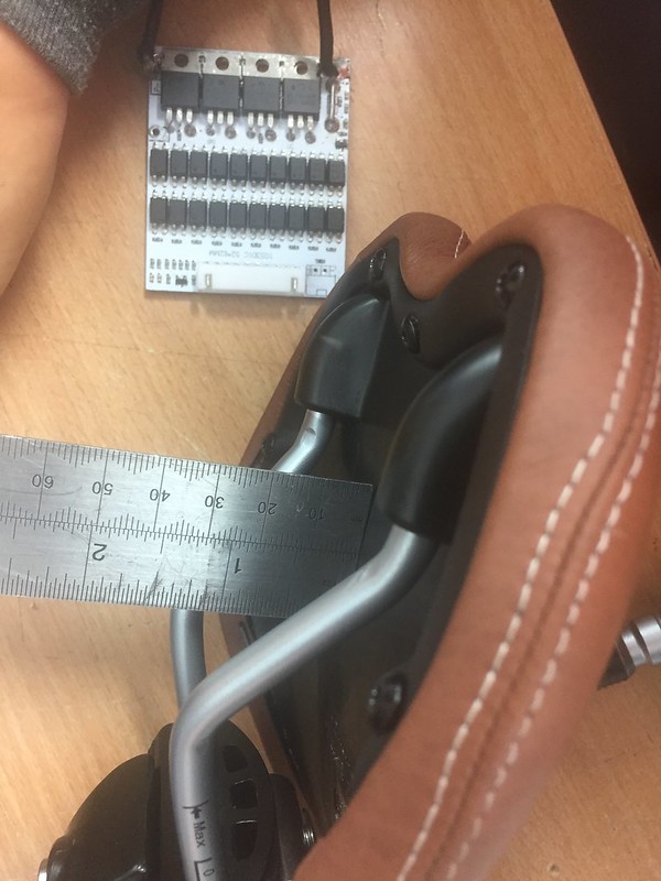

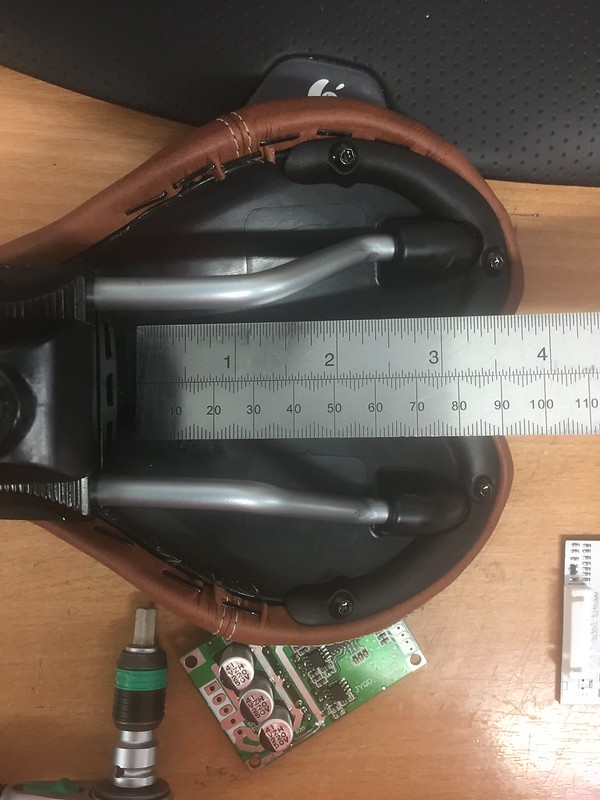

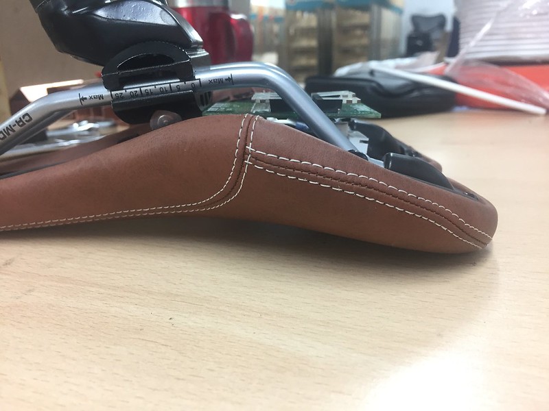

Saddle Bag
This is a quick mock up I've made of the hard case to go under the saddle. Dims in mm. (it's upside down, the heat sync would be the only bit visible from the side of the saddle).
A few photos showing rough dimensions of the saddle.
Pretty tight packaging, but i'm sure with some good contact area to the heat sync it should stay cool, if not i'll know about it pretty quick through the saddle.

If the bottom (or top depending on orientation) of the heat sink could be extended outward such that it clamps on to the seat bars then that would add a much deeper heat well....just a thought.
If you build a rear light into the back side of this saddle, even a close inspection will just look like its a safety rear light.

@MrDude_1 I've been thinking about this! It was between that or adding a little clip on the back to easily put a light on, i could copy the profile from another light.
Frame Modifications
I think I may have finished hacking up my frame now, I made the cut in the lower rear arm for the motor cable.

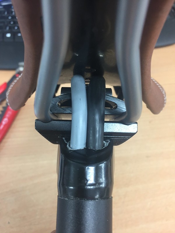

Seatpost Modification
I've drilled the seatpost for the cable routing between the saddle case and the frame. I've found there is nearly no room at all in the frame at the seatpost for connectors, especially since 21 wires have to be connected there. I think this means I'm going to have to solder, more annoying to disassemble if something breaks, but it looks like the only way. These are just some cables I found spare at work with no specs on, the 20 core looks good for the balancing and communication wires. The 6 core I'm not sure is thick enough for the battery and motor wires (and it's grey), so I'll replace it with one I know can hack it.

Motor Modification
I cut the motor wire and soldered up all the connections.
To get the bearing to slot over the shaft and the wire I had to remove a little material and strip the outer sheathing from the wire so it could lay flat.
And it's done.
